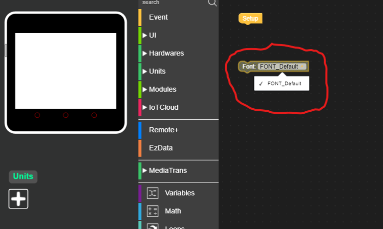

Hi, I can't choose the font for CORE 2, there is only a basic font. Thanks for the help.</p>
<p dir="auto"><img src="/assets/uploads/files/1638996613701-2021-12-08-212408-resized.png" alt="0_1638996615453_2021-12-08 212408.png" class=" img-fluid img-markdown" /></p>
