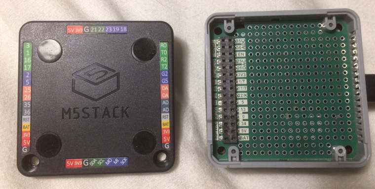

I will order the connectors.<br />
I did the quick test and it works well, but I used the proto module to get the pins numbers.</p>
<p dir="auto">Is there a table with the corresponding pin numbers of the proto module and the back of the m5stack core?<br />
<img src="/assets/uploads/files/1541400221039-m5back-resized.jpg" alt="0_1541400220276_m5back.jpg" class=" img-fluid img-markdown" /><br />
For example, where is pin 13 on the back of the m5stack core?</p>
<p dir="auto">I have everything to learn!</p>

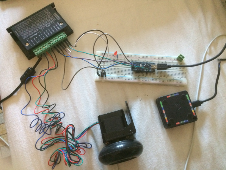

<p dir="auto">I have a step motor driver TB6600, I use the following arduino sketch by connecting the PIN 2, 5 and 8 on the Arduino Nano.</p>
<p dir="auto">// defines pins numbers<br />
const int stepPin = 5;<br />
const int dirPin = 2;<br />
const int enPin = 8;</p>
<p dir="auto">void setup() {<br />
// Sets the two pins as Outputs<br />
pinMode(stepPin,OUTPUT);<br />
pinMode(dirPin,OUTPUT);<br />
pinMode(enPin,OUTPUT);</p>
<p dir="auto">I would like to use the same thing on the m5stack but I can not find the good PIN.</p>
<p dir="auto">Include right libraries and use a stepmotor library with non blocking code (interrupt driven, so you can update the display, play sound etc.). Anyway for a quick test you can modify your code. Here I use pin 13, but there are many free pins.</p>
<p dir="auto">#include &lt;M5Stack.h&gt;</p>
<p dir="auto">const int stepPin = 5;<br />
const int enPin = 13;</p>
<p dir="auto">//add this to setup<br />
m5.begin();<br />
<p dir="auto">M5.Lcd.clear(BLACK);<br />
M5.Lcd.setTextColor(RED);<br />
M5.Lcd.setTextSize(2);<br />
M5.Lcd.setCursor(65, 10);<br />
M5.Lcd.println("STEPMOTOR");<br />
M5.Speaker.mute();</p>
<p dir="auto">//add this to loop<br />
void loop() {<br />
m5.update();</p>
<p dir="auto">Connect ground, Pin 2, 5, 13 with your driver. However, because the M5stack is 3.3V the signal level might be too low for your driver expecting 5V and you need a level converter.</p>

<p dir="auto"><img src="/assets/uploads/files/1541344752886-img_2627-small-resized.jpg" alt="0_1541344708095_IMG_2627-small.jpg" class=" img-fluid img-markdown" /></p>
<p dir="auto">thank you</p>

can you help me on a concrete example?<br />
pinMode(enPin,OUTPUT);<br />
digitalWrite(enPin,LOW);</p>
<p dir="auto">}</p>
<p dir="auto">void loop() {</p>
<p dir="auto">digitalWrite(dirPin,HIGH); // Enables the motor to move in a particular direction<br />
// Makes 200 pulses for making one full cycle rotation</p>
<p dir="auto">for(int x = 0; x &lt; 200; x++) {<br />
digitalWrite(stepPin,HIGH);<br />
delayMicroseconds(200);<br />
digitalWrite(stepPin,LOW);<br />
}</p>
<p dir="auto">delay(1000); // One second delay</p>
<p dir="auto">digitalWrite(dirPin,LOW); //Changes the rotations direction<br />
// Makes 400 pulses for making two full cycle rotation</p>
<p dir="auto">for(int x = 0; x &lt; 400; x++) {<br />
delayMicroseconds(500);<br />
}</p>
<p dir="auto">delay(1000);</p>
<p dir="auto">}</p>
