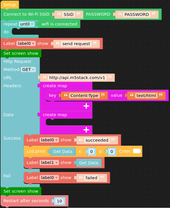

<p dir="auto">no worries. I am glad to hear you got it working to your liking. And thank you for reporting back.</p>

Seems to be working fine indeed, my M5Paper app restarts for now every 30 minutes, running since yesterday afternoon and barely any battery consumption yet. Perfect.</p>

<p dir="auto">the last statement <code>Restart after seconds 10</code> actually turns everything off except for the RTC. After 10 seconds the RTC powers on the system which restarts the code from the top. While in shutdown mode I measure about 3.5 micro ampere at the battery.</p>
<p dir="auto">Thanks<br />
Felix</p>

]]></description><link>https://community.m5stack.com/post/15899</link><guid isPermaLink="true">https://community.m5stack.com/post/15899</guid><dc:creator><![CDATA[littlbee]]></dc:creator><pubDate>Mon, 20 Dec 2021 20:19:51 GMT</pubDate></item><item><title><![CDATA[Reply to M5Paper deepsleep with UIFlow ? on Mon, 20 Dec 2021 20:10:31 GMT]]></title><description><![CDATA[<p dir="auto">Hello <a class="plugin-mentions-user plugin-mentions-a" href="/user/littlbee" aria-label="Profile: littlbee">@<bdi>littlbee</bdi></a></p>
<p dir="auto">below code connects to WiFi, sends a HTTP request and then shuts down for 10 seconds. After 10 seconds the process repeats itself.</p>
<p dir="auto">Note: for the code example to work the code need to be downloaded into M5Paper. If you only execute the code from within UIFlow it will be lost after the restart.</p>
<p dir="auto">Note: for the code example to work M5Paper needs to run from battery. If USB is plugged in M5Paper doesn't really turn off and hence the RTC cannot restart it.</p>
<p dir="auto"><img src="/assets/uploads/files/1640031019151-uiflowm5papershutdownhttpexample20211220.png" alt="0_1640031017724_UIFlowM5PaperShutdownHttpExample20211220.png" class=" img-fluid img-markdown" /></p>
Felix</p>
]]></description><link>https://community.m5stack.com/post/15898</link><guid isPermaLink="true">https://community.m5stack.com/post/15898</guid><dc:creator><![CDATA[felmue]]></dc:creator><pubDate>Mon, 20 Dec 2021 20:10:31 GMT</pubDate></item></channel></rss>
