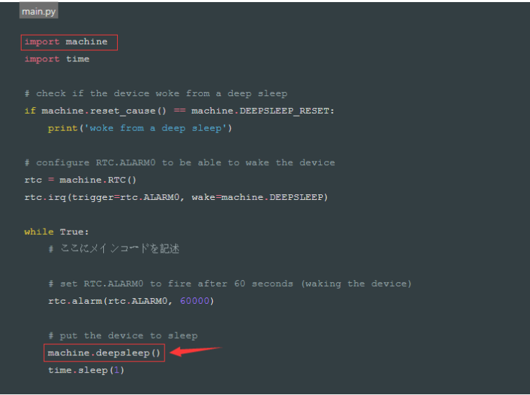

<p dir="auto">You can put M5 to deep sleep using <code>machine.deepsleep()</code></p>
<p dir="auto">similar to this.</p>
<p dir="auto"><a href="https://qiita.com/taka-murakami/items/0d2b4734b08516135d74" target="_blank" rel="noopener noreferrer nofollow ugc">https://qiita.com/taka-murakami/items/0d2b4734b08516135d74</a></p>
<p dir="auto"><img src="/assets/uploads/files/1542614938260-tim%E6%88%AA%E5%9B%BE20181119160843-resized.png" alt="0_1542614938118_TIM截图20181119160843.png" class=" img-fluid img-markdown" /></p>
