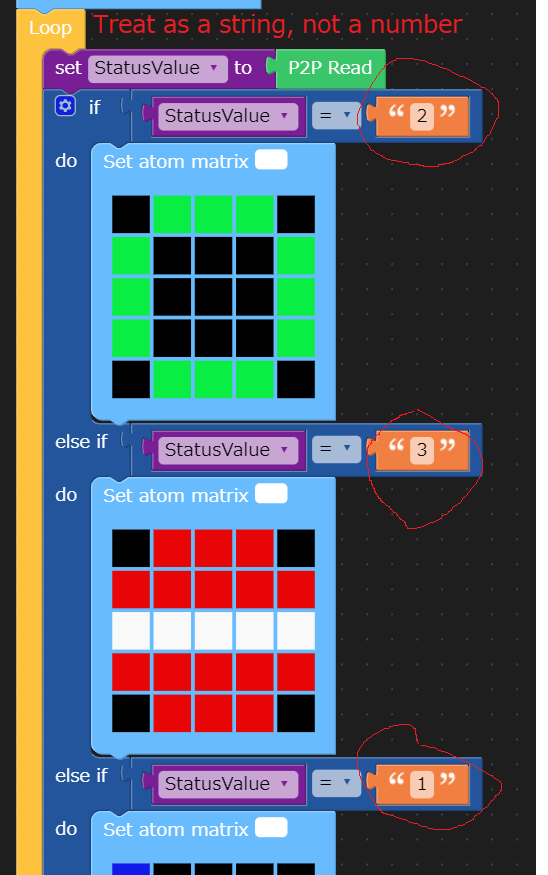

The key to solving this problem was the "character string".<br />
I assumed that the content sent by P2P was not a "string" but a "number".<br />
It may be hard to see, but I will attach the screen created by UIflow.<br />
I'm an amateur, but I'm glad I worked hard to solve it.<br />
(The attached image is the receiving Atom Matrix)</p>
<p dir="auto"><img src="/assets/uploads/files/1641013484391-atom-matrix-receiving-side.png" alt="0_1641013490221_Atom Matrix receiving side.png" class=" img-fluid img-markdown" /></p>

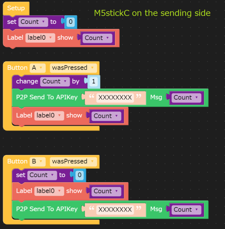

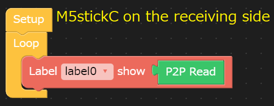

Based on this, I am thinking of UIFlow for Atom Matrix.<br />
I would be grateful if anyone had any good advice.</p>
<p dir="auto"><img src="/assets/uploads/files/1640914497958-m5stickc-on-the-receiving-side.png" alt="1_1640914504401_M5stickC on the receiving side.png" class=" img-fluid img-markdown" /></p>
<p dir="auto"><img src="/assets/uploads/files/1640914498000-m5stickc-on-the-sending-side-resized.png" alt="0_1640914504399_M5stickC on the sending side.png" class=" img-fluid img-markdown" /></p>
