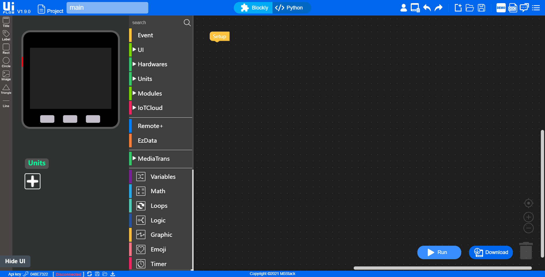

<p dir="auto"><a class="plugin-mentions-user plugin-mentions-a" href="/user/felmue" aria-label="Profile: felmue">@<bdi>felmue</bdi></a></p>
<p dir="auto">Now the button move to the bottom right,one is call "Run" means the workspace's code only run once,if you reboot the device code won't run again,and another one call "Download" means downlaod the workspace's code to the device filesystem and run, the code in the deivce won't disappear when you reboot or somethings.</p>
<p dir="auto">In a word, "Run" button is recommend for developing mode, and "Download" button is deploy after develop.</p>
</blockquote>
<p dir="auto">Hello <a class="plugin-mentions-user plugin-mentions-a" href="/user/iamliubo" aria-label="Profile: IAMLIUBO">@<bdi>IAMLIUBO</bdi></a></p>
<p dir="auto">understood, but that was not my point. I am only talking about the "Download" button which when pressed shows a popup saying "Uploading".</p>
<p dir="auto"><img src="/assets/uploads/files/1644914996007-uiflowupload220215.png" alt="0_1644914996019_UiFlowUpload220215.png" class=" img-fluid img-markdown" /></p>
<p dir="auto">but it's really just a cosmetic issue - don't worry about it.</p>
<p dir="auto">Thanks<br />
Felix</p>
]]></description><link>https://community.m5stack.com/post/16657</link><guid isPermaLink="true">https://community.m5stack.com/post/16657</guid><dc:creator><![CDATA[IAMLIUBO]]></dc:creator><pubDate>Tue, 15 Feb 2022 02:14:27 GMT</pubDate></item><item><title><![CDATA[Reply to UIFlow 1.9.0 on Mon, 14 Feb 2022 11:53:20 GMT]]></title><description><![CDATA[<p dir="auto"><a class="plugin-mentions-user plugin-mentions-a" href="/user/iamliubo" aria-label="Profile: IAMLIUBO">@<bdi>IAMLIUBO</bdi></a> im getting memory allocation errors when using 1.9.1 with azure. It looks to be that azure is filling the memory requiring the Core2 to be reset in order to update UIFlow program.</p>

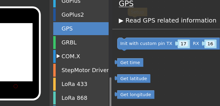

<p dir="auto">the default GPIOs for the GPS module are incorrect when using M5Core2. They should be GPIO14 and GPIO13 (instead of GPIO17 and GPIO 16).</p>
<p dir="auto"><img src="/assets/uploads/files/1644306474005-uiflow_m5core2_gps_incorrect_gpio_220208.png" alt="0_1644306473016_UiFlow_M5Core2_GPS_incorrect_GPIO_220208.png" class=" img-fluid img-markdown" /></p>
Felix</p>

<p dir="auto">thank you for the new version of UIFlow.</p>
<p dir="auto">One thing that always strikes me as inconsistent is the fact that the button to load a program onto an M5Stack device is labelled <strong>Download</strong> whereas the information while it is happening (at the top right) says <strong>Upload</strong>.</p>
Felix</p>
]]></description><link>https://community.m5stack.com/post/16027</link><guid isPermaLink="true">https://community.m5stack.com/post/16027</guid><dc:creator><![CDATA[felmue]]></dc:creator><pubDate>Mon, 03 Jan 2022 06:03:40 GMT</pubDate></item></channel></rss>
