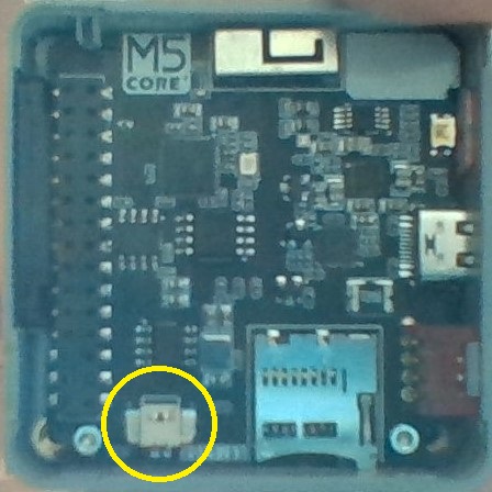

                            As per my other post, I too have battery charging issues. My M5Stack will only work consistently with the bottom off. And yes, I tried different USB power sources which I monitored via a USB power meter. All were solid. I will try the SAM sleep mode just for kicks.

                                • P Offline

                                  @kaotiklabs, I tried charging while sleeping and no go, the battery does not charge and The M5Stack runs seconds before shutting down.
                                  I have the latest PS-RAM unit and there is a battery connector on the on the motherboard.
                                  However, I haven't been able to tell which side of the connector is + and which is -.
                                  JJJ 1 Reply Last reply Reply Quote 0

                                    Hi, off hand I'm not sure which is + and -.
                                    I believe the connector on that is a JST SH with 1.0 pin pitch with side not top mounting. But you will be doing well to have one of those on hand !! They can be purchased though.

                                      The positive pin is on the side of the 2x15 connector, the negative one is on the side of the SD slot.
                                      I also presumed the size is JST SH and order a battery, but I cannot confirm yet.

                                        I have a proto module and will connect a known good 3.7v LiPo to the BATT terminals and try charging and using it. If that dosen't work, I will test battery via JST SH on main board. I have a strong suspicion the charger may not be working.
                                        • P Offline
                                          pkourany
                                          I tested with a battery connected to the VBAT and GND terminals of the proto module. I now realize the issue is with the charger chip:
                                          • A fully charged battery will boot the unit and it will run for a few seconds and then turn off
                                          • Without any battery, the M5Stack often will not power up when USB is plugged. I need to press the power button several times to get it to power up. Often, that won't even work. The same applies when powered by battery only or battery + USB power.
                                          I now believe I have a defective M5Stack unit. How do I go about getting a replacement?
