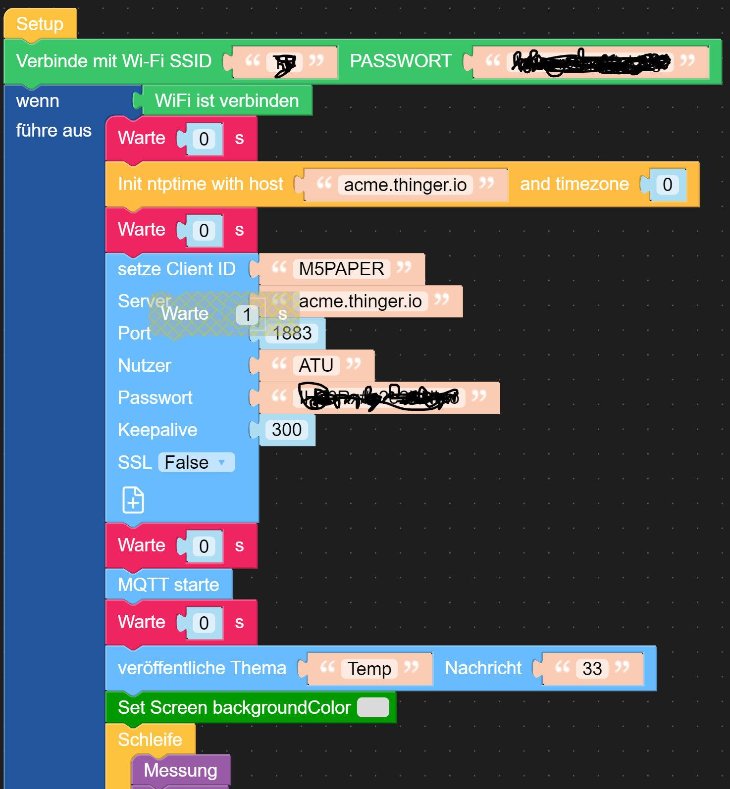

<?xml version="1.0" encoding="UTF-8"?><rss xmlns:dc="http://purl.org/dc/elements/1.1/" xmlns:content="http://purl.org/rss/1.0/modules/content/" xmlns:atom="http://www.w3.org/2005/Atom" version="2.0"><channel><title><![CDATA[UIFLOW MQTT with thinger.io]]></title><description><![CDATA[<p dir="auto">I bought a M5PAPER and want to exchange data with UIFLOW via MQTT with the provider <a href="http://thinger.io" target="_blank" rel="noopener noreferrer nofollow ugc">thinger.io</a>.<br />
I have tried a few things, but I can not do it.<br />
Does anyone have experience?</p>
<p dir="auto"><img src="/assets/uploads/files/1641540627960-9cc9c778-7656-449f-8bbf-366327725fdb-image-resized.png" alt="0_1641540641442_9cc9c778-7656-449f-8bbf-366327725fdb-image.png" class=" img-fluid img-markdown" /></p>

Yes thanks, that can not work I have only the free version, thus without MQTT at <a href="http://Thinger.io" target="_blank" rel="noopener noreferrer nofollow ugc">Thinger.io</a></p>

<p dir="auto">could you be a bit more specific about what doesn't work for you? Is there a problem with the MQTT connection to <a href="http://thinger.io" target="_blank" rel="noopener noreferrer nofollow ugc">thinger.io</a> or a problem with showing results on M5Paper screen or something different?</p>
<p dir="auto">Also according to the <a href="https://pricing.thinger.io/#!/cloud" target="_blank" rel="noopener noreferrer nofollow ugc">thinger.io price</a> list MQTT is only supported with <strong>paid</strong> accounts. Do you use a paid account?</p>
<p dir="auto">Thanks<br />
