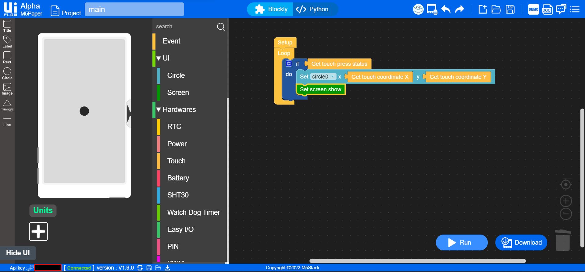

<p dir="auto">i am trying to create a home automation with M5Paper and M5Flow. I flashed the UIFlow 1.9.0 to the device, but somehow the touch is only working when on USB-power.</p>
<p dir="auto">To reproduce the problem i wrote a very easy flow:</p>
<p dir="auto"><img src="/assets/uploads/files/1641776183289-2022-01-10-01_55_14-resized.jpg" alt="0_1641776179822_2022-01-10 01_55_14-.jpg" class=" img-fluid img-markdown" /></p>
<p dir="auto">I burned the program via "Download" to the M5Paper.</p>

<p dir="auto">hmm, your code example runs fine on my M5Paper from battery. So no, I don't think you're doing something wrong.</p>
<p dir="auto">The only idea I have at this point is that maybe the battery is too weak to initialize the touch screen properly? Have you tried to charge your M5Paper for a couple of hours before trying again?</p>
