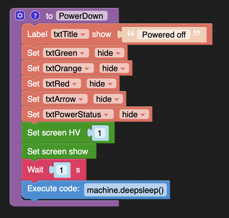

<p dir="auto">Just developed a neat little bit of code in UIFlow that performs various GETs on URLs, which in turn set off Alexa routines.</p>
<p dir="auto">It works perfectly, but I've run into a problem.</p>
<p dir="auto">After each URL is triggered, I want to power down the Coreink to save battery.  The idea being, is that someone will power it on when they want to perform a function.  However, using the Hardware --&gt; Power --&gt; Power off block doesn't seem to work.  The function that it runs in works as expected, but the actual power off doesn't do anything.  I'm still able to interact with the device.</p>
<p dir="auto">For now, what I've done is to change the "power off" block for an execute one, that runs <code>machine.deepsleep()</code>.</p>
<p dir="auto">This does work, but it's obviously not powering down the device completely.</p>
<p dir="auto">Is there some magic that needs to be performed to get the "power off" block to work?</p>
<p dir="auto">This is how the function currently looks:</p>
<p dir="auto"><img src="/assets/uploads/files/1642025763520-flowexample-resized.png" alt="0_1642025761927_FlowExample.png" class=" img-fluid img-markdown" /></p>
<p dir="auto">And the rendered MPython:</p>
<pre><code>def PowerDown():
  global ArrowPos
  txtTitle.setText(' Powered off')
  txtGreen.hide()
  txtOrange.hide()
  txtRed.hide()
  txtArrow.hide()
  txtPowerStatus.hide()
  coreInkSetHV(1)
  coreInkShow()
  wait(1)
  machine.deepsleep()
</code></pre>
<p dir="auto">If I change that <code>machine.deepsleep()</code> to <code>power.off()</code>, then the code keeps running!</p>
<p dir="auto">Any ideas?</p>
