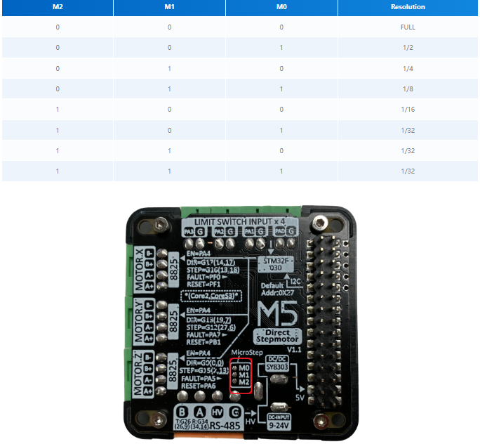

<img src="/assets/uploads/files/1692080962672-58079694-f05e-44e4-aab7-ea4f39cdf1a2-image.png" alt="0_1692080976549_58079694-f05e-44e4-aab7-ea4f39cdf1a2-image.png" class=" img-fluid img-markdown" /></p>
