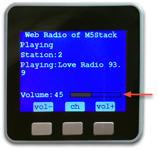

<p dir="auto">I don't know UIFlow, but there are bar graphs in the Arduino IDE.</p>
<p dir="auto">The LCD has a progressBar command.<br />
<a href="https://github.com/m5stack/m5-docs/blob/master/docs/en/api/lcd.md" target="_blank" rel="noopener noreferrer nofollow ugc">https://github.com/m5stack/m5-docs/blob/master/docs/en/api/lcd.md</a><br />
progressBar(int x, int y, int w, int h, uint8_t val);</p>
