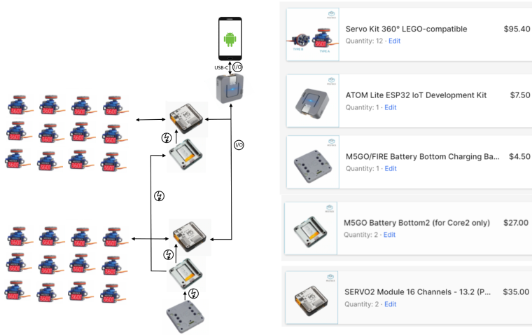

<p dir="auto">on the way of making a robot i am currently at the point of diving into hardware. The actual simulation and servo-controls runs on mobile phone (Android, utilizing the GPU).</p>
<p dir="auto">So i like to send the controls (angular-velocities) via USB-C into a micro-controller at which the servos and batteries are attached to. The micro-controller will apply these to the servos, as well as collecting and reporting-back the servo angular-positions.</p>
<p dir="auto">Quite optimistic from the software-side (C++) i am surely lost in hardware-land and hope to get this step by step.</p>
<p dir="auto">To use 24 servos in total is it possible to use an<br />
ATOM Lite ESP32<br />
and control with it TWO separate<br />
SERVO2-Modules<br />
with each a<br />
Battery-Module<br />
and each<br />
12 Servos (360°)</p>
<p dir="auto">It would be great to charge both Battery-Modules by attaching a single magnetic Charging-Base at one.<br />
(In the future i like to add cameras to the setup and send the images via USB-C to the phone as well. Maybe the ATOM wont have enough power to pipe all this data so it may need CORE anyway?)</p>
<p dir="auto">I'd love to build the frame for a prototype with LEGO so all this M5Stack hardware appears so perfect. Can you folks please hint me if the setup above makes kinda sense or point me into some proper direction?</p>
<p dir="auto">Thanks and happy building!</p>

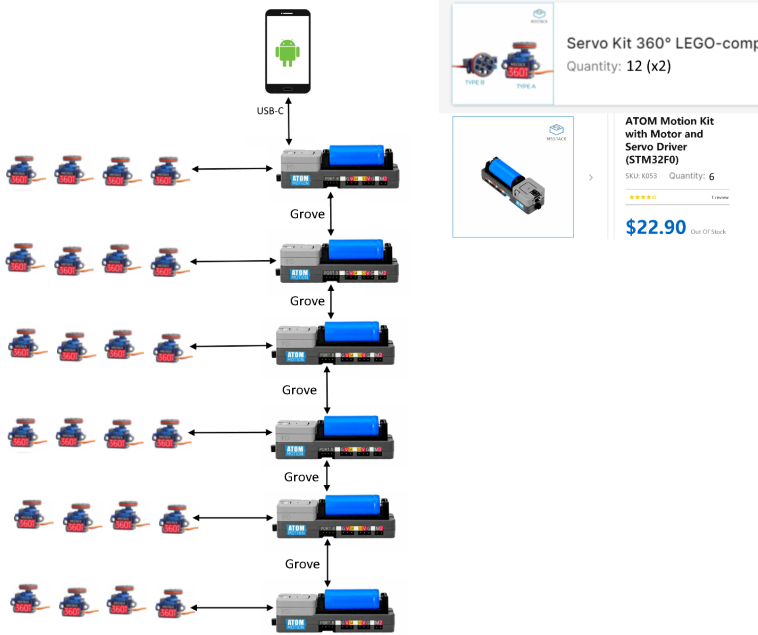

in software the servo-controls get piped from the usb-connection down the Ports through all the ATOMs.<br />
<img src="/assets/uploads/files/1642875505402-bb0556b4-238b-47e4-88ad-b90d90f978c1-image.png" alt="0_1642875503705_bb0556b4-238b-47e4-88ad-b90d90f978c1-image.png" class=" img-fluid img-markdown" /></p>
<p dir="auto">Maybe this sounds reasonable. Sadly the ATOM Motion Kit is currently Out of Stock</p>
<p dir="auto">edit: in case the servo-controls can not be passed easily/quickly though the row-connection (e.g. the data needs to be received and sent by each ATOM with major delay), it may make sense to connect them using a PaHUB2 and an additional ATOM for parallel distribution?</p>

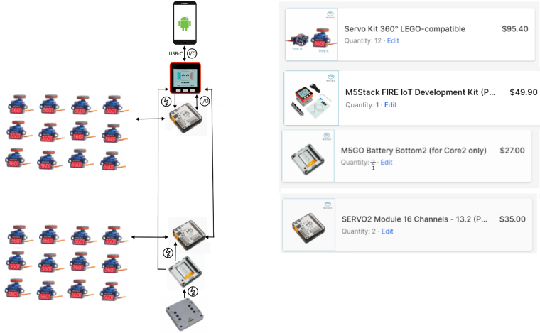

<p dir="auto">just to be clear. The servos attached to the SERVO2 module will <strong>not</strong> be powered from the Battery Module (or the battery bottom of the FIRE). The Battery Module will only power the M5Stack device.</p>
<p dir="auto">The SERVO2 module has a separate <strong>VBAT_2</strong> line which is <strong>not</strong> connected to the <strong>VBAT</strong> of the Battery Module or M5Stack device. Check the schematic <a href="https://docs.m5stack.com/en/module/servo2" target="_blank" rel="noopener noreferrer nofollow ugc">here</a>. Subsequently the magnetic charger will only charge the battery for the M5Stack.</p>
<p dir="auto">You'll need to attach a separate battery to the SERVO2 module directly at the <strong>DC INPUT (6 - 12V)</strong> using the provided thick wired cable. And it probably will need substantially more capacity than the 500mAh of the Battery module anyways. One servo has a rated <em>Locked rotor current</em> of about <strong>750mA</strong> and your battery needs to drive 12 of them. See specification <a href="https://shop.m5stack.com/products/servo-kit-360" target="_blank" rel="noopener noreferrer nofollow ugc">here</a>.</p>
<p dir="auto">And you'll have to charge the battery for the servos with an external charger.</p>
<p dir="auto">I would probably start w/o the battery for the servos and initially power them through an external power supply. With that setup you could measure the DC current of the working robot and then depending on how long it should run from battery decide on the size and capacity of the battery. (Which will add additional weight to the robot.)</p>

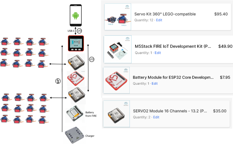

<p dir="auto"><img src="/assets/uploads/files/1642804442869-abc4fbb7-6ee1-4706-8456-98f021ad194b-image-resized.png" alt="0_1642804434965_abc4fbb7-6ee1-4706-8456-98f021ad194b-image.png" class=" img-fluid img-markdown" /></p>

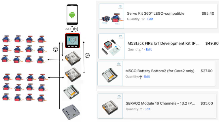

<p dir="auto"><img src="/assets/uploads/files/1642791508184-304310cc-82a3-4b4a-84df-09fb7421d376-image-resized.png" alt="0_1642791500749_304310cc-82a3-4b4a-84df-09fb7421d376-image.png" class=" img-fluid img-markdown" /></p>
<p dir="auto">its great that the FIRE does have a Battery-Bottom already and i assume this is a very basic setup now. maybe it would be more straight forward to make a single stack but making two interconnected stacks like in the image is surely possible.</p>
<p dir="auto">Maybe removing the Battery-Modules and get the power right instead. (Though i really like the magnetic charging-connector ;)</p>
