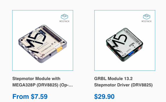

<p dir="auto">I think you may be thinking of the servo module as the ones I have and the product title shows AATMEGA328<br />
<img src="/assets/uploads/files/1642866373912-screenshot-2022-01-22-at-15.44.52.png" alt="0_1642866371685_Screenshot 2022-01-22 at 15.44.52.png" class=" img-fluid img-markdown" /><br />
the 13.2 uses the STM32</p>
]]></description><link>https://community.m5stack.com/post/16305</link><guid isPermaLink="true">https://community.m5stack.com/post/16305</guid><dc:creator><![CDATA[ajb2k3]]></dc:creator><pubDate>Sat, 22 Jan 2022 15:46:50 GMT</pubDate></item><item><title><![CDATA[Reply to Some questions... on Sat, 22 Jan 2022 09:17:52 GMT]]></title><description><![CDATA[<p dir="auto">Hello <a class="plugin-mentions-user plugin-mentions-a" href="/user/ajb2k3" aria-label="Profile: ajb2k3">@<bdi>ajb2k3</bdi></a></p>
<p dir="auto">I think you might still be thinking about the wrong module. (I know it's a bit confusing as both these modules are listed on the specs page.)</p>
<p dir="auto">The Stepmotor Driver Module (HR8825) uses an TCA9554 and not an STM32. So no open source firmware as far as I can see.</p>
