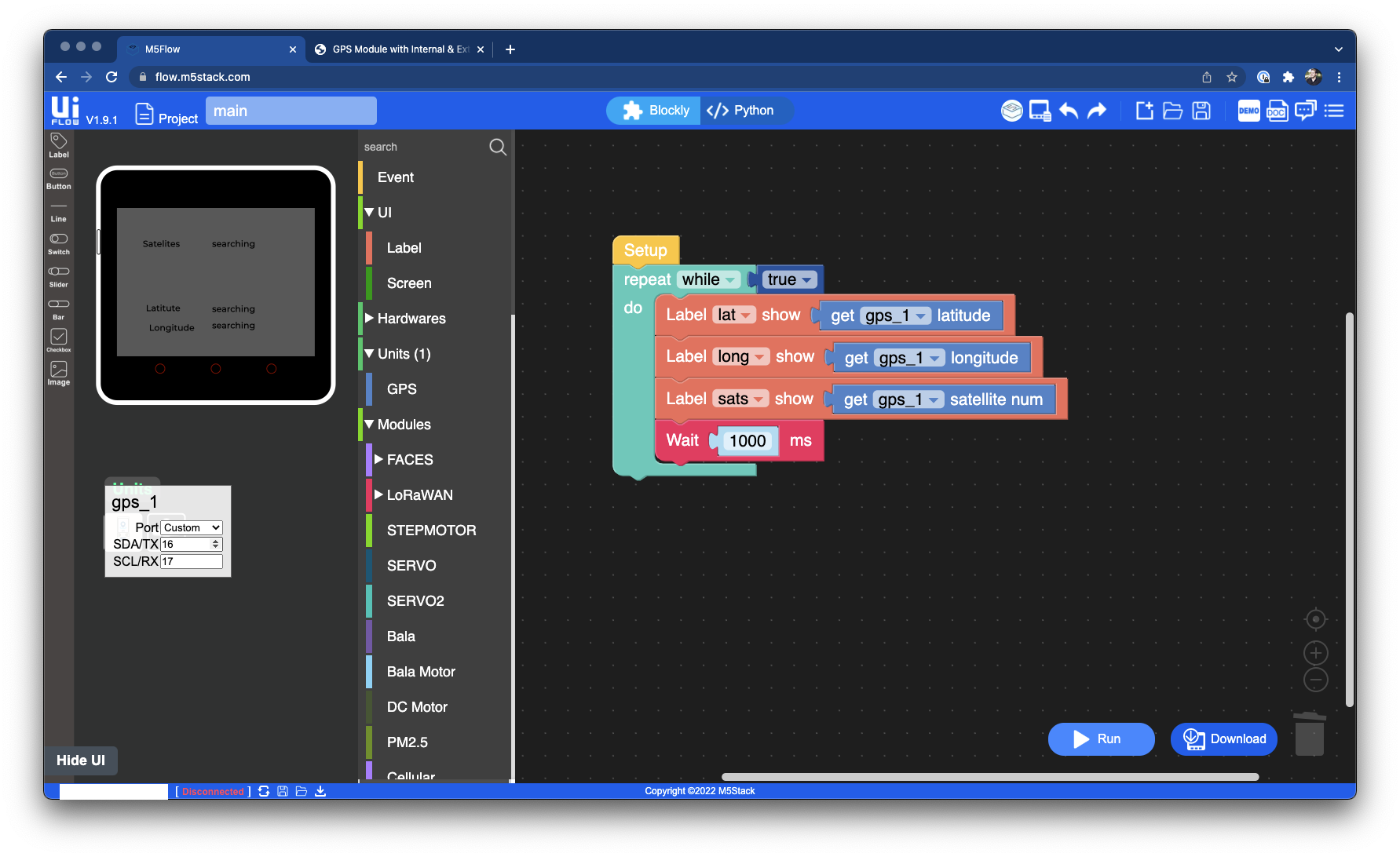

<?xml version="1.0" encoding="UTF-8"?><rss xmlns:dc="http://purl.org/dc/elements/1.1/" xmlns:content="http://purl.org/rss/1.0/modules/content/" xmlns:atom="http://www.w3.org/2005/Atom" version="2.0"><channel><title><![CDATA[How to get the GPS Unit NEO-M8 working with the Core 2]]></title><description><![CDATA[<p dir="auto">Hi everyone, i'm new to the M5Stack. I'm trying to get the GPS Module on my Core 2 running. The application (i guess at least) crashes and restarts the unit.</p>
<p dir="auto">From the Unit Part of UI Flow my GPS is not listed there, so i took the only GPS module available.</p>
<p dir="auto">Here is the software:</p>
<p dir="auto"><img src="/assets/uploads/files/1643356816770-screenshot-2022-01-28-at-08.48.46-resized.png" alt="0_1643356813856_Screenshot 2022-01-28 at 08.48.46.png" class=" img-fluid img-markdown" /></p>

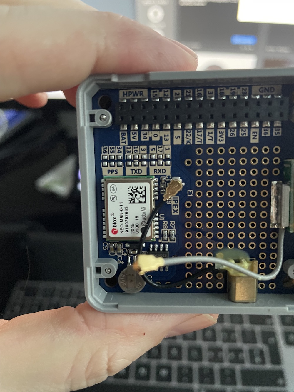

<p dir="auto">And this is the hardware:<br />
<img src="/assets/uploads/files/1643357019735-img_5679.jpeg" alt="0_1643357018489_IMG_5679.jpeg" class=" img-fluid img-markdown" /><br />
<img src="/assets/uploads/files/1643357030617-img_5678-resized.jpeg" alt="0_1643357027233_IMG_5678.jpeg" class=" img-fluid img-markdown" /></p>
<p dir="auto">Hope someone could give me a Hand to start in this world ;)</p>

<p dir="auto">some GPIOs on the M5 bus have changed between M5Stack (Basic, Go, Fire) and M5Core2. I've mad a <a href="https://www.gwendesign.ch/kb/m5stack/m5core2/#m5core2-bus-and-gpios-compared-to-m5stack" target="_blank" rel="noopener noreferrer nofollow ugc">table</a> a while ago which lists the differences.</p>
<p dir="auto">In short M5Core2 uses GPIO16 and GPIO17 internally for PSRAM - that is why it doesn't work and crashes. Try GPIO13 and GPIO14 instead.</p>
<p dir="auto">Note: the GPIO numbers printed on most (if not all) modules are the GPIO numbers used for when stacked to an M5Stack (Basic, Go, Fire). If the module is stacked to an M5Core2 you'll need to do some translation.</p>
<p dir="auto">Edit: I've just tried the UiFlow GPS blocks myself - even when selecting M5Core2 the selected default GPIOs are incorrect. I guess that is something the M5Stack engineers should fix. (Posted <a href="https://community.m5stack.com/topic/3875/uiflow-1-9-0/6">here</a>.)</p>
<p dir="auto">Thanks<br />

<p dir="auto">in the M5Stack world there are modules and units. Modules are stacked under the cores, whereas units are connected via Groove cable.</p>
<p dir="auto">The GPS device you have (judging from the posted picture) is a module and therefore you'll find its blocks under <code>Modules</code> - <code>GPS</code>.</p>
