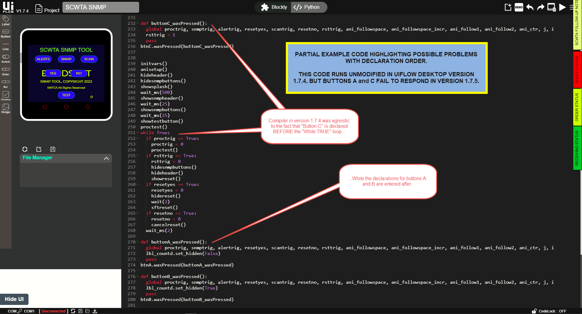

<li>While testing by moving elements, recreating the project in the different versions, and in different orders, I found that for some reason, (using the copy of the very first, fully functional script as an example for troubleshooting) the new UIFlow version 1.7.5 editor placed the declarations for the button 1,2, and 3 event responder functions into the code window AFTER the declaration for the infinite loop. And this was not consistent, either, because sometimes it would place the responder for one or two of the buttons BEFORE the infinite loop, causing THOSE to respond, but not the one declared after the loop.</li>
</ol>
<p dir="auto">Using the new version of UIFlow to create a project seems to have some influence on the order in which the function descriptors are entered, but I am still working to learn if the declaration order remains fixed.</p>
<p dir="auto">WORKAROUND:</p>
<p dir="auto">By going into the code editor, I cut the declarations for the button events out from under the infinite loop, and place them above the loop declaration, trying to remember that these will be overwritten if I use the UIFlow "side" to expand the project.</p>
<p dir="auto">EXAMPLE OF PYTHON CODE, WORKING IN VERSION 1.7.4, BUT NOT IN VERSION 1.7.5:</p>
<p dir="auto"><img src="/assets/uploads/files/1644344134899-b9d9a7ef-0276-4d34-8bb2-c7ddb64bc8ca-image-resized.png" alt="0_1644344121383_b9d9a7ef-0276-4d34-8bb2-c7ddb64bc8ca-image.png" class=" img-fluid img-markdown" /></p>
