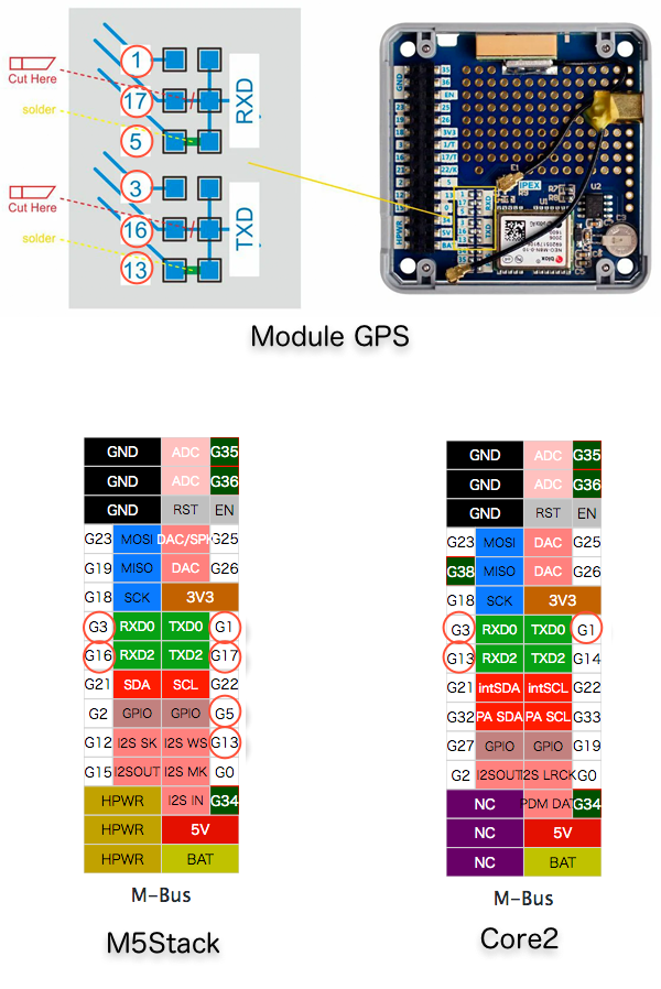

<?xml version="1.0" encoding="UTF-8"?><rss xmlns:dc="http://purl.org/dc/elements/1.1/" xmlns:content="http://purl.org/rss/1.0/modules/content/" xmlns:atom="http://www.w3.org/2005/Atom" version="2.0"><channel><title><![CDATA[GPS Module reboot problems]]></title><description><![CDATA[<p dir="auto">I am trying out the GPS module on the Core 2, but when I init the custom ports (TX16,RX17) and run a script through UIFlow the device crashes. I've read that you can solder the module to a different pin, but I first wanted to be sure I am not doing anything wrong.</p>

<p dir="auto">there should be no need to cut traces in the GPS module. For M5Core2 defining GPIO13 and GPIO14 in UiFlow (instead of GPIO16 and GPIO17) should do the trick. Or am I missing something?</p>

<p dir="auto"><a href="https://docs.m5stack.com/en/module/gps" target="_blank" rel="noopener noreferrer nofollow ugc">https://docs.m5stack.com/en/module/gps</a></p>
<p dir="auto">M5Unified<br />
<a href="https://github.com/m5stack/M5Unified" target="_blank" rel="noopener noreferrer nofollow ugc">https://github.com/m5stack/M5Unified</a></p>
<p dir="auto">The GPIO placement of M5Stack Basic and M5Satck Core2 is different.</p>
<p dir="auto"><img src="/assets/uploads/files/1644497279491-gps_gpio.png" alt="0_1644497225733_GPS_GPIO.png" class=" img-fluid img-markdown" /></p>
