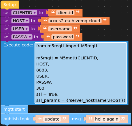

            Javi
            Hi @ajb2k3 @felmue
            I have been working with the configuration you told me to connect with HiveMQ cloud with ssl. Now, using it I have seen an error. It does not subscribe to the topics a need to. See an easy example.
            Here, when I press the button, the message "vamos" is send and it appears in the broker topic "hola" as it has to. But the button does not turn red. If I use the MQTT configuration block instead of the one that execute the code to connect it to a public server it all works properly, but I need to do the same in the private server with the ssl.
            Thanks for your help.
            • J Offline
              Javi
              Maybe there is a parmeter left in the code because I´ve tried to connect to the public server with the code and it happens the same

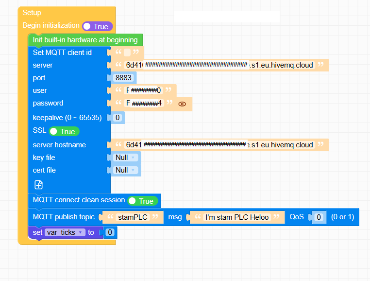

                        for Hive MQTT below works for me Uiflow 2.2.5
