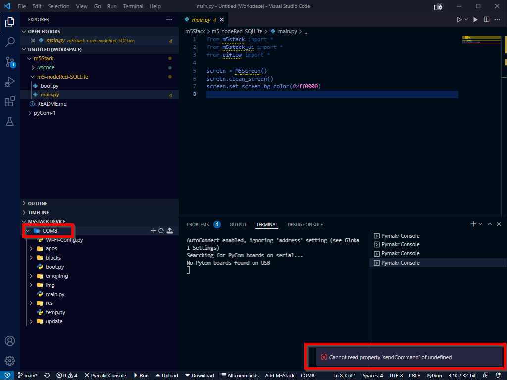

<p dir="auto">I'm having problems with running code from VSCode on Core2, since my VSCode auto updated recently. When I click the "Run in M5Stack" button in VSCode...</p>
<p dir="auto">"Cannot read property 'sendCommand' of Undefined"<br />
<img src="/assets/uploads/files/1647014595180-f3d69a5e-c864-40a7-a5bb-078c272cec36-image-resized.png" alt="0_1647014595074_f3d69a5e-c864-40a7-a5bb-078c272cec36-image.png" class=" img-fluid img-markdown" /></p>
<p dir="auto">Has anyone else experienced this? Is there a fix?</p>

]]></description><link>https://community.m5stack.com/topic/4119/core2-vscode-cannot-read-property-sendcommand-of-undefined</link><generator>RSS for Node</generator><lastBuildDate>Wed, 29 Apr 2026 11:28:51 GMT</lastBuildDate><atom:link href="https://community.m5stack.com/topic/4119.rss" rel="self" type="application/rss+xml"/><pubDate>Fri, 11 Mar 2022 16:05:15 GMT</pubDate><ttl>60</ttl><item><title><![CDATA[Reply to Core2 &#x2F; VSCode : &quot;Cannot read property &#x27;sendCommand&#x27; of Undefined&quot; on Sun, 13 Nov 2022 18:28:11 GMT]]></title><description><![CDATA[<p dir="auto">Just replying to an old topic as it might help someone in the future - I was just struggling with the same error.  Turns out you need to be editing a python file on the device itself to be able to run it.  Under the '<a href="http://main.py" target="_blank" rel="noopener noreferrer nofollow ugc">main.py</a>' tab at the top right of your screen shot, you can see that this file is located in folder 'm5stack ...'.  This should show 'COM8 &gt; flash &gt; <a href="http://main.py" target="_blank" rel="noopener noreferrer nofollow ugc">main.py</a>' or similar if you are editing the version on the device (just click on the '<a href="http://main.py" target="_blank" rel="noopener noreferrer nofollow ugc">main.py</a>' under your highlit 'COM8' on the bottom left to select the file on the device before trying to run rather than the file on your local PC).</p>
