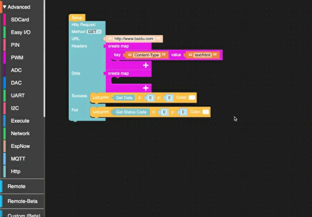

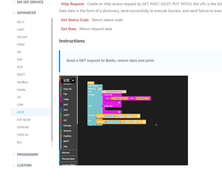

<?xml version="1.0" encoding="UTF-8"?><rss xmlns:dc="http://purl.org/dc/elements/1.1/" xmlns:content="http://purl.org/rss/1.0/modules/content/" xmlns:atom="http://www.w3.org/2005/Atom" version="2.0"><channel><title><![CDATA[Where is documentation of the http capability in UIFlow?]]></title><description><![CDATA[<p dir="auto">I want to issue a GET to an endpoint and retrieve a single string that it returns as text.  I cannot find documentation demonstrating how to do this?  I'm also comfortable using python but prefer to take advantage of UIFlow if possible.  Specifically, I don't see how to retrieve the value returned from the GET operation.  Thanks</p>
]]></description><link>https://community.m5stack.com/topic/4125/where-is-documentation-of-the-http-capability-in-uiflow</link><generator>RSS for Node</generator><lastBuildDate>Wed, 29 Apr 2026 22:36:00 GMT</lastBuildDate><atom:link href="https://community.m5stack.com/topic/4125.rss" rel="self" type="application/rss+xml"/><pubDate>Thu, 17 Mar 2022 10:55:36 GMT</pubDate><ttl>60</ttl><item><title><![CDATA[Reply to Where is documentation of the http capability in UIFlow? on Mon, 21 Mar 2022 06:52:58 GMT]]></title><description><![CDATA[<p dir="auto"><img src="/assets/uploads/files/1647845552721-6ea68bb9-f75d-4783-b3c4-40ac804fc97d-6f045c56ef79c9a3f20b9763fd3de5a.png" alt="0_1647845554889_6ea68bb9-f75d-4783-b3c4-40ac804fc97d-6f045c56ef79c9a3f20b9763fd3de5a.png" class=" img-fluid img-markdown" /><br />
<img src="/assets/uploads/files/1647845571398-ad174f92-a01e-4167-a6e0-8b892c1ab58e-7f5b2e48b8c1746e59c9e1451328ab3-resized.png" alt="0_1647845573314_ad174f92-a01e-4167-a6e0-8b892c1ab58e-7f5b2e48b8c1746e59c9e1451328ab3.png" class=" img-fluid img-markdown" /></p>
]]></description><link>https://community.m5stack.com/post/16967</link><guid isPermaLink="true">https://community.m5stack.com/post/16967</guid><dc:creator><![CDATA[M5Stack_AG]]></dc:creator><pubDate>Mon, 21 Mar 2022 06:52:58 GMT</pubDate></item><item><title><![CDATA[Reply to Where is documentation of the http capability in UIFlow? on Mon, 21 Mar 2022 06:48:39 GMT]]></title><description><![CDATA[<p dir="auto">Hi David, please refer to this link<br />
<a href="https://docs.m5stack.com/en/uiflow/advanced/http" target="_blank" rel="noopener noreferrer nofollow ugc">https://docs.m5stack.com/en/uiflow/advanced/http</a></p>
