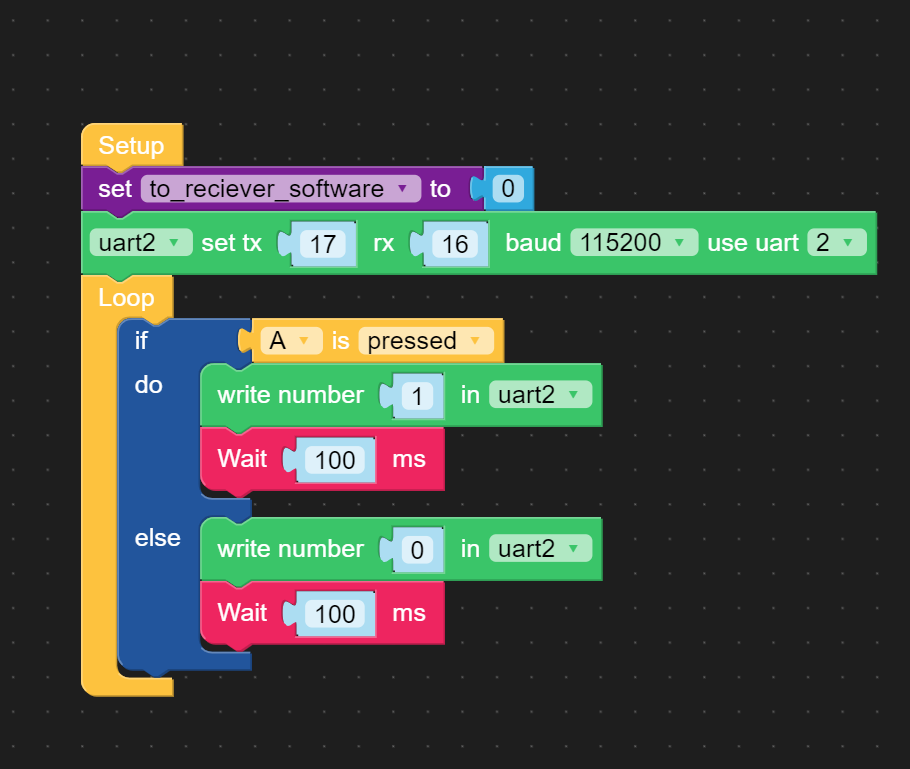

<?xml version="1.0" encoding="UTF-8"?><rss xmlns:dc="http://purl.org/dc/elements/1.1/" xmlns:content="http://purl.org/rss/1.0/modules/content/" xmlns:atom="http://www.w3.org/2005/Atom" version="2.0"><channel><title><![CDATA[Send serial data thru usb from M5stack Fire , to another software with serial data input.]]></title><description><![CDATA[<p dir="auto">It seems that the Fire doesn't transmit serial data thru usb?? ony thru softserial?<br />
Are both (1, 2) uarts wire serials?, if yes, I would need to buy a uart to usb adapter??</p>
<p dir="auto">this are my blocks:</p>
<p dir="auto"><img src="/assets/uploads/files/1648063265526-send-serial-m5stack-fire-resized.png" alt="0_1648063263584_send serial m5stack fire.png" class=" img-fluid img-markdown" /></p>

<p dir="auto">you'll need to use different GPIO than 16 and 17 for serial. On M5Stack Fire GPIO 16 and 17 are used internally for PSRAM. See <a href="https://shop.m5stack.com/collections/m5-controllers/products/m5stack-fire-iot-development-kit-psram-v2-6" target="_blank" rel="noopener noreferrer nofollow ugc">here</a>.</p>
<p dir="auto">Quote from above link:<br />
<em>Note:<br />
GPIO 16 / 17 of FIRE are connected to PSRAM by default, so when you connect or stack other modules, you need to pay attention to avoid conflicts with these two pins to prevent the device from not working properly and generating instability..</em></p>
<p dir="auto">Thanks<br />
Felix</p>
