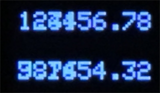

<p dir="auto">If there is no background color<br />
<img src="/assets/uploads/files/1649211602135-t1.png" alt="0_1649211605482_t1.png" class=" img-fluid img-markdown" /></p>

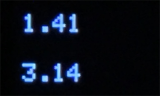

<p dir="auto">If there is a background color<br />
<img src="/assets/uploads/files/1649211642320-t2.png" alt="0_1649211646347_t2.png" class=" img-fluid img-markdown" /></p>
