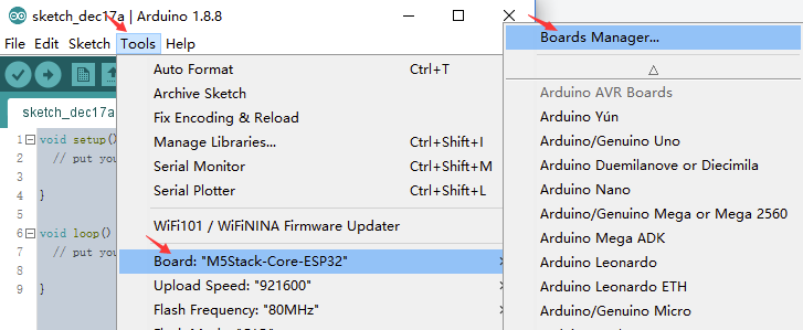

<p dir="auto">To be careful...</p>
<p dir="auto">I want to update this link(<a href="https://dl.espressif.com/dl/package_esp32_index.json" target="_blank" rel="noopener noreferrer nofollow ugc">https://dl.espressif.com/dl/package_esp32_index.json</a>) for downloading ESP32 Board Support.</p>
<p dir="auto">this link is out-of-date that need to be replaced by the lastest one(<a href="https://github.com/espressif/arduino-esp32/releases/download/1.0.1-rc1/package_esp32_dev_index.json%22" target="_blank" rel="noopener noreferrer nofollow ugc">https://github.com/espressif/arduino-esp32/releases/download/1.0.1-rc1/package_esp32_dev_index.json"</a>). The lastest one is 1.0.1-rc version.</p>
<p dir="auto">Othewise, if we have used the old link(<a href="https://dl.espressif.com/dl/package_esp32_index.json" target="_blank" rel="noopener noreferrer nofollow ugc">https://dl.espressif.com/dl/package_esp32_index.json</a>), we need to update esp32 board support by "Board Manager" of Arduino IDE</p>
<p dir="auto"><img src="/assets/uploads/files/1545147885662-283409d4-f775-4fe7-bdbd-84298a4124bc-image.png" alt="0_1545147882738_283409d4-f775-4fe7-bdbd-84298a4124bc-image.png" class=" img-fluid img-markdown" /></p>
<p dir="auto"><img src="/assets/uploads/files/1545147932281-ec7bf195-985b-444e-9b08-c62dfadd6b5f-image-resized.png" alt="0_1545147929571_ec7bf195-985b-444e-9b08-c62dfadd6b5f-image.png" class=" img-fluid img-markdown" /></p>

<li>A: How to get the lastest json file?</li>
<li>Q: According to this link: <a href="https://github.com/espressif/arduino-esp32/releases" target="_blank" rel="noopener noreferrer nofollow ugc">https://github.com/espressif/arduino-esp32/releases</a><br />
<img src="/assets/uploads/files/1545148229986-tim%E6%88%AA%E5%9B%BE20181218234920-resized.png" alt="0_1545148227025_TIM截图20181218234920.png" class=" img-fluid img-markdown" /><br />
otherwise, we need update esp32 board through Arduino IDE</li>
</ul>
