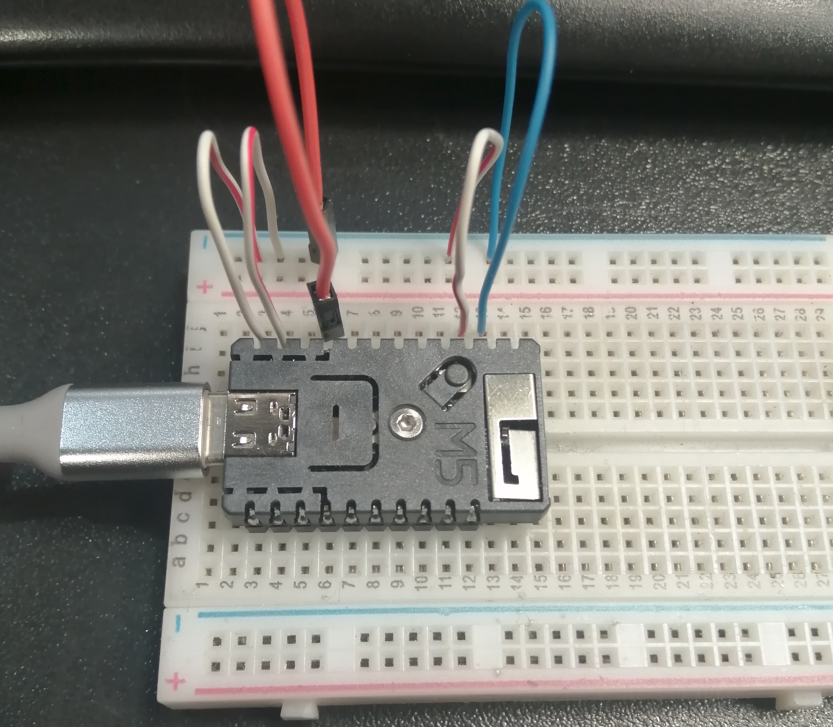

<?xml version="1.0" encoding="UTF-8"?><rss xmlns:dc="http://purl.org/dc/elements/1.1/" xmlns:content="http://purl.org/rss/1.0/modules/content/" xmlns:atom="http://www.w3.org/2005/Atom" version="2.0"><channel><title><![CDATA[M5STAMP C3 ANALOG INPUT]]></title><description><![CDATA[<p dir="auto">I recently bought a M5stamp C3 because it has the ability to convert at least 4 analog inputs.</p>
<p dir="auto"><img src="/assets/uploads/files/1651208877754-5862ab34-0c50-40e8-ba7a-cffb652848bd-image-resized.png" alt="0_1651208875130_5862ab34-0c50-40e8-ba7a-cffb652848bd-image.png" class=" img-fluid img-markdown" /></p>
<p dir="auto">In arduino IDE I have entered the following code but A2 and A3 do not change value even if I carry 0V.<br />
<img src="/assets/uploads/files/1651206901108-152859ba-f481-48a7-aa18-1d389cad0fb8-image.png" alt="0_1651206900293_152859ba-f481-48a7-aa18-1d389cad0fb8-image.png" class=" img-fluid img-markdown" /></p>
<p dir="auto">A0 and A1 read 20 digits (0V) while A2 and A3 read high values ​​as if they were not correctly connected to 0V</p>
<p dir="auto"><img src="/assets/uploads/files/1651208542097-472e89f7-e413-4878-a0df-869b54257155-image.png" alt="0_1651208539999_472e89f7-e413-4878-a0df-869b54257155-image.png" class=" img-fluid img-markdown" /></p>
<p dir="auto">Anyone have any advice?</p>

]]></description><link>https://community.m5stack.com/post/17371</link><guid isPermaLink="true">https://community.m5stack.com/post/17371</guid><dc:creator><![CDATA[zan]]></dc:creator><pubDate>Mon, 02 May 2022 16:53:49 GMT</pubDate></item><item><title><![CDATA[Reply to M5STAMP C3 ANALOG INPUT on Fri, 29 Apr 2022 06:32:31 GMT]]></title><description><![CDATA[<p dir="auto">Hello <a class="plugin-mentions-user plugin-mentions-a" href="/user/zan" aria-label="Profile: zan">@<bdi>zan</bdi></a></p>
<p dir="auto">looks like work in progress. See this <a href="https://github.com/espressif/arduino-esp32/issues/5502" target="_blank" rel="noopener noreferrer nofollow ugc">post</a>.</p>
<p dir="auto">Thanks<br />
Felix</p>
