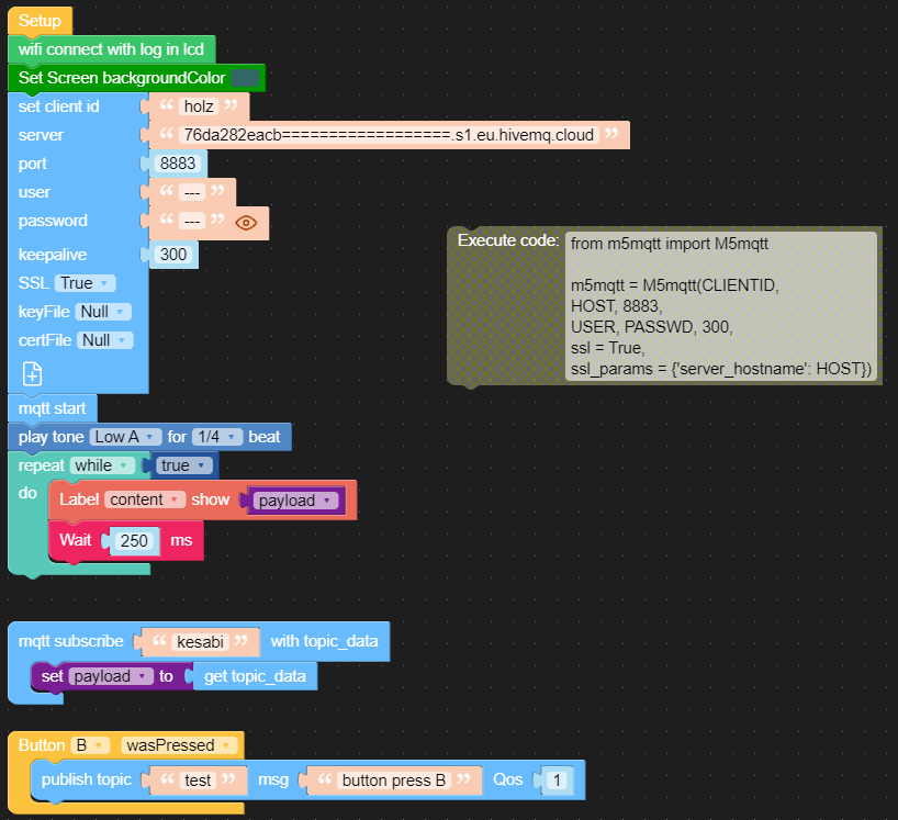

<p dir="auto">I have trouble with connecting my Core2 to HiveMQ using MQTT.</p>
<p dir="auto">What works well so far:</p>
<ul>
<li>Connecting to a public MQTT broker (hivemq or mosquitto) with no auth (and no SSL) works perfectly fine.</li>
<li>Connecting to my private cloud broker works and I can send messages (from core2 to hivemq) when using the 'execute code' block.</li>
</ul>
<p dir="auto">What does not work and drives me kind of crazy is that I don't receive any messages on the topics I subscribed to -- when being connected to the private cloud instance using SSL.</p>
<p dir="auto">Any hints on what is wrong are greatly appreciated :)</p>
<p dir="auto">Cheers, Alex</p>

]]></description><link>https://community.m5stack.com/post/17378</link><guid isPermaLink="true">https://community.m5stack.com/post/17378</guid><dc:creator><![CDATA[ajb2k3]]></dc:creator><pubDate>Tue, 03 May 2022 09:10:57 GMT</pubDate></item><item><title><![CDATA[Reply to Core2 MQTT fails to subscribe on SSL=True on Tue, 03 May 2022 07:01:15 GMT]]></title><description><![CDATA[<p dir="auto">Thanks a lot <a class="plugin-mentions-user plugin-mentions-a" href="/user/ajb2k3" aria-label="Profile: ajb2k3">@<bdi>ajb2k3</bdi></a> and <a class="plugin-mentions-user plugin-mentions-a" href="/user/felmue" aria-label="Profile: felmue">@<bdi>felmue</bdi></a> for your swift responses! Good point with the subscribe statement -- and thanks for pointing out that I need to set keys and certs, I wasn't aware of that.</p>
<p dir="auto">I'm sure your answers will help others, too :)</p>

<p dir="auto">Hello <a class="plugin-mentions-user plugin-mentions-a" href="/user/ajb2k3" aria-label="Profile: ajb2k3">@<bdi>ajb2k3</bdi></a></p>
<p dir="auto">ah, ok, thank you for the information. I was not aware of that.</p>
<p dir="auto">Thanks<br />
Felix</p>
<p dir="auto">No worries, it's not a well know feature.</p>

If you check out the Execute Code block the params are different.<br />
For some reason there is an oddity with security lately that if SSL is set to true in MicroPython the the files are required.</p>
<p dir="auto">Also the main program functions need to be run in a loop placed after the MQTT Start block.</p>

<p dir="auto">afaik, the client <code>keyFile</code> and <code>certFile</code> are optional and only required if the MQTT broker is setup to verify the MQTT client. Or am I missing something?</p>
Felix</p>

<p dir="auto">it looks like the generated micropython code is missing the statement to actually subscribe. I have to add something like below, in an <code>Execute Code</code> block, just before the <code>mqtt start</code> block to make the subscription work:</p>
<pre><code>m5mqtt.subscribe(str('kesabi'), fun_kesabi_)
</code></pre>
Felix</p>

]]></description><link>https://community.m5stack.com/post/17340</link><guid isPermaLink="true">https://community.m5stack.com/post/17340</guid><dc:creator><![CDATA[ajb2k3]]></dc:creator><pubDate>Sat, 30 Apr 2022 11:20:46 GMT</pubDate></item></channel></rss>
