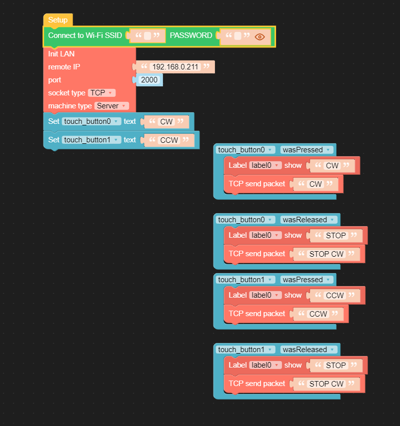

<p dir="auto">Trying to connect to my Wifi accesspoint and connect to a tcpip server and send some text when a button is pressed</p>
<p dir="auto">after the connection with the wifi AP the screen hangs and no tcpip connection is setup?</p>
<p dir="auto"><img src="/assets/uploads/files/1651606165549-59d2949e-c75e-452a-8318-7f7d51bb6503-image-resized.png" alt="0_1651606164639_59d2949e-c75e-452a-8318-7f7d51bb6503-image.png" class=" img-fluid img-markdown" /></p>

<p dir="auto">not that I am aware of, no. I don't see any general TCP blocks in UiFlow. You probably would need to use MicroPython directly.</p>
<p dir="auto">Thanks<br />

]]></description><link>https://community.m5stack.com/post/17398</link><guid isPermaLink="true">https://community.m5stack.com/post/17398</guid><dc:creator><![CDATA[felmue]]></dc:creator><pubDate>Wed, 04 May 2022 13:51:43 GMT</pubDate></item><item><title><![CDATA[Reply to M5stack core 2 TCPIP connection example on Wed, 04 May 2022 13:28:33 GMT]]></title><description><![CDATA[<p dir="auto"><a class="plugin-mentions-user plugin-mentions-a" href="/user/felmue" aria-label="Profile: felmue">@<bdi>felmue</bdi></a> Thank Felix, yes i found that out after my post, is there a way to do a TCP socket client,similar to the UDP socket option in UI ?</p>

<p dir="auto">the <code>Init LAN</code> block can only be used in conjunction with the <a href="https://docs.m5stack.com/en/base/lan_v12" target="_blank" rel="noopener noreferrer nofollow ugc">LAN Module</a> (Ethernet). Do you have a LAN Module stacked to your M5Core2?</p>
