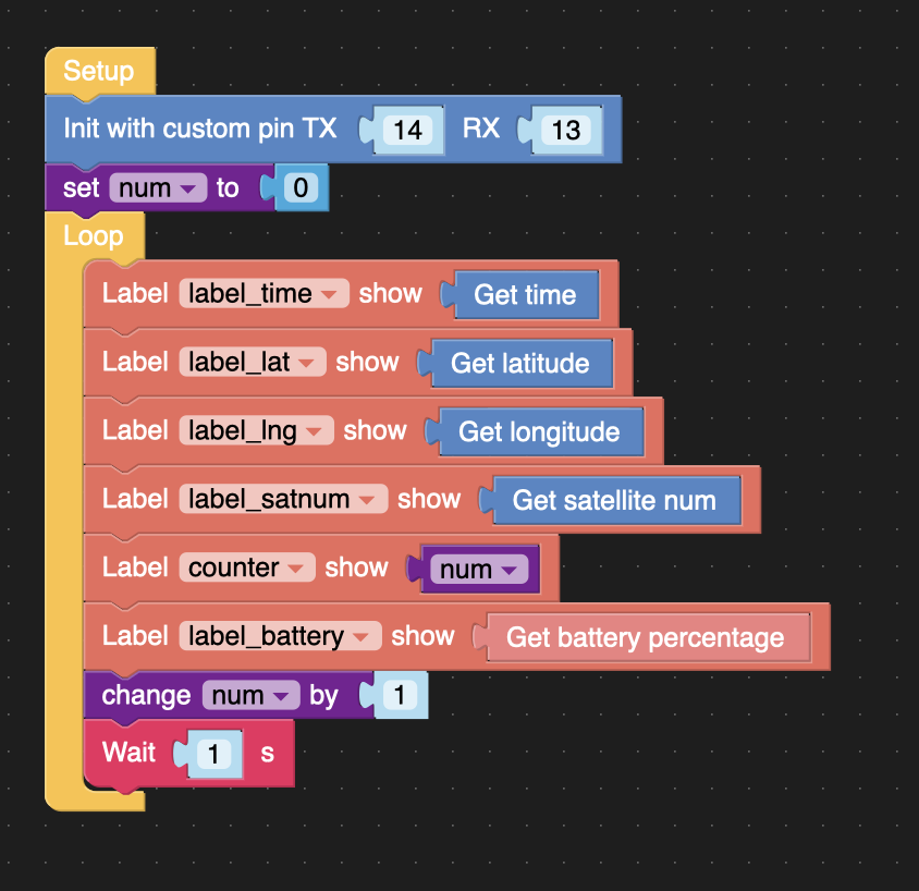

<?xml version="1.0" encoding="UTF-8"?><rss xmlns:dc="http://purl.org/dc/elements/1.1/" xmlns:content="http://purl.org/rss/1.0/modules/content/" xmlns:atom="http://www.w3.org/2005/Atom" version="2.0"><channel><title><![CDATA[GPS Module + Core 2]]></title><description><![CDATA[<p dir="auto">I am using v1.9.6 of UIFlow with a Core2. I have connected the GPS module and even though I get time I cannot get any lock to a satellite and longitude+latitude measurements. I have placed the units outside for at least a minute, but nothing.</p>
<p dir="auto">Any ideas? I am showing the source and the setup.<br />
<img src="/assets/uploads/files/1651998566192-img_2025.png" alt="0_1651998544220_IMG_2025.png" class=" img-fluid img-markdown" /></p>
<p dir="auto"><img src="/assets/uploads/files/1651998707597-img_2026.png" alt="0_1651998681720_IMG_2026.png" class=" img-fluid img-markdown" /></p>
<p dir="auto"><img src="/assets/uploads/files/1651998624025-screenshot-2022-05-08-at-10.29.29-resized.png" alt="0_1651998621371_Screenshot 2022-05-08 at 10.29.29.png" class=" img-fluid img-markdown" /></p>

<p dir="auto">from what I understand the GPS module only supports one antenna at the time connected to the connector labelled IPEX. It looks to me that currently the internal antenna is connected (gray cable). Have you tried to switch and connect the external antenna (black cable) instead?</p>
<p dir="auto">Thanks<br />
Felix</p>
