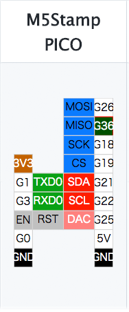

<p dir="auto">The pin assign is below.<br />
m5stack / M5Unified Public<br />
<a href="https://github.com/m5stack/M5Unified" target="_blank" rel="noopener noreferrer nofollow ugc">https://github.com/m5stack/M5Unified</a><br />
:<br />
<img src="/assets/uploads/files/1652061135380-pico.png" alt="0_1652061167471_pico.png" class=" img-fluid img-markdown" /></p>
