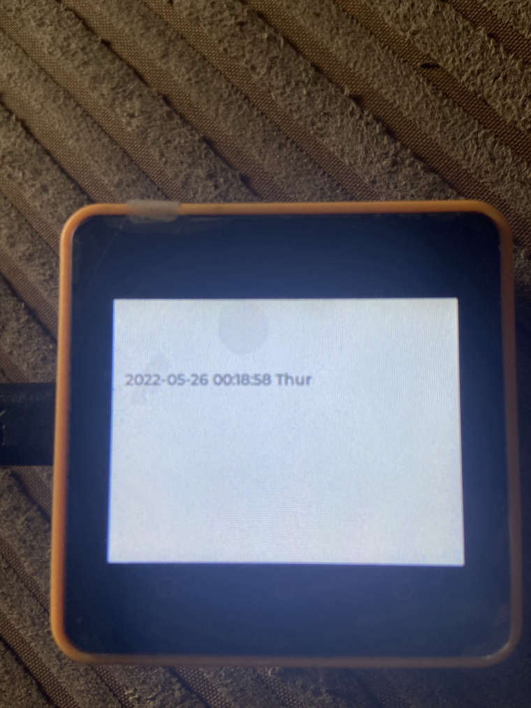

This shows it in the format you want <img src="/assets/uploads/files/1653495528753-screenshot-2022-05-25-at-17.18.00.png" alt="0_1653495527966_Screenshot 2022-05-25 at 17.18.00.png" class=" img-fluid img-markdown" /><br />

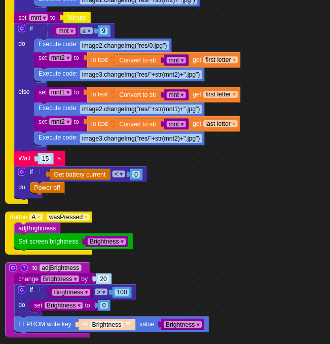

<p dir="auto">I was thinking that I could use an If statement...so if the minute value was less than 10 (say), you add '0' to the front of the number, same with the hour etc.</p>
]]></description><link>https://community.m5stack.com/post/17560</link><guid isPermaLink="true">https://community.m5stack.com/post/17560</guid><dc:creator><![CDATA[iamjameshannam]]></dc:creator><pubDate>Wed, 25 May 2022 12:48:29 GMT</pubDate></item><item><title><![CDATA[Reply to Help with RTC block in UIFlow &#x2F; Blocks on Tue, 24 May 2022 21:45:42 GMT]]></title><description><![CDATA[<p dir="auto">You have to do it one character at a time, using “first letter” and “last letter”.  For example (in the if/do/else block):<img src="/assets/uploads/files/1653428552850-838f761a-6860-49e0-99bc-4b4f3a38ec39.png" alt="0_1653428551357_838F761A-6860-49E0-99BC-4B4F3A38EC39.png" class=" img-fluid img-markdown" /></p>
<p dir="auto">In C or Python code of course you’d just use sprintf() or the equivalent.</p>
