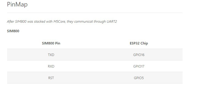

<p dir="auto">There is no serial port named "USART2".</p>
<p dir="auto">I need a complete pinout for this board.</p>

Hello, vidarr</p>
<p dir="auto">Here's pinmap<br />
<img src="/assets/uploads/files/1544149228717-sim800-resized.jpg" alt="0_1544149229120_sim800.JPG" class=" img-fluid img-markdown" /></p>
<p dir="auto"><a href="https://m5stack.github.io/m5-docs/#/en/product_documents/modules/module_sim800" target="_blank" rel="noopener noreferrer nofollow ugc">https://m5stack.github.io/m5-docs/#/en/product_documents/modules/module_sim800</a></p>
