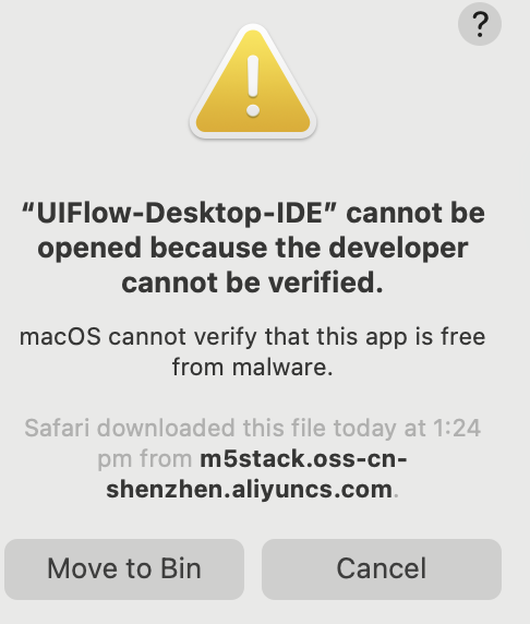

<?xml version="1.0" encoding="UTF-8"?><rss xmlns:dc="http://purl.org/dc/elements/1.1/" xmlns:content="http://purl.org/rss/1.0/modules/content/" xmlns:atom="http://www.w3.org/2005/Atom" version="2.0"><channel><title><![CDATA[Mac OS and UI Flow IDE]]></title><description><![CDATA[<p dir="auto">![alt text](<img src="/assets/uploads/files/1653805677624-screen-shot-2022-05-29-at-4.13.49-pm.png" alt="0_1653805675050_Screen Shot 2022-05-29 at 4.13.49 pm.png" class=" img-fluid img-markdown" /> image url)</p>
<p dir="auto">Has anyone been able to overcome this error.<br />
I have tried placing in applications and loading but with no use.<br />
I get a similar message with the Burner.</p>
<p dir="auto">Is their a link to a solution, using a M1 Power book with  Monterrery12.1</p>
<p dir="auto">Thanks</p>
<p dir="auto">Raymond</p>
]]></description><link>https://community.m5stack.com/topic/4330/mac-os-and-ui-flow-ide</link><generator>RSS for Node</generator><lastBuildDate>Wed, 29 Apr 2026 22:36:58 GMT</lastBuildDate><atom:link href="https://community.m5stack.com/topic/4330.rss" rel="self" type="application/rss+xml"/><pubDate>Sun, 29 May 2022 06:29:51 GMT</pubDate><ttl>60</ttl><item><title><![CDATA[Reply to Mac OS and UI Flow IDE on Tue, 31 May 2022 04:47:29 GMT]]></title><description><![CDATA[<p dir="auto">Or just go to security and preferences click on the general tab, click on the padlock and then click approve.</p>
]]></description><link>https://community.m5stack.com/post/17616</link><guid isPermaLink="true">https://community.m5stack.com/post/17616</guid><dc:creator><![CDATA[ajb2k3]]></dc:creator><pubDate>Tue, 31 May 2022 04:47:29 GMT</pubDate></item><item><title><![CDATA[Reply to Mac OS and UI Flow IDE on Mon, 30 May 2022 23:56:48 GMT]]></title><description><![CDATA[<p dir="auto"><a class="plugin-mentions-user plugin-mentions-a" href="/user/iamjameshannam" aria-label="Profile: iamjameshannam">@<bdi>iamjameshannam</bdi></a></p>

<p dir="auto">It’s when the app isn’t approved by the Apple (for app store use).</p>
<p dir="auto">The way to overcome is to hold down Control first, then right click on the app. Then select open.</p>
<p dir="auto">That’s it.</p>
<p dir="auto">Here’s the Apple Guide: <a href="https://support.apple.com/en-gb/guide/mac-help/mh40616/mac" target="_blank" rel="noopener noreferrer nofollow ugc">https://support.apple.com/en-gb/guide/mac-help/mh40616/mac</a></p>
<p dir="auto">I hope that helps!</p>
