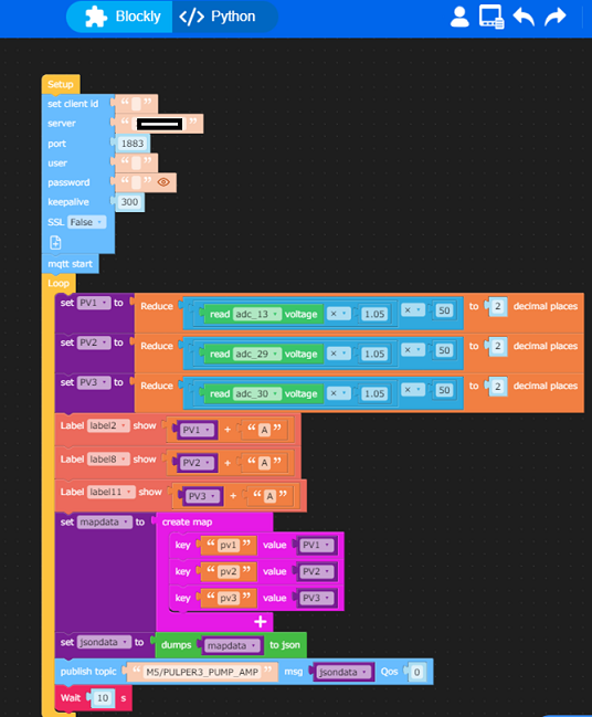

<?xml version="1.0" encoding="UTF-8"?><rss xmlns:dc="http://purl.org/dc/elements/1.1/" xmlns:content="http://purl.org/rss/1.0/modules/content/" xmlns:atom="http://www.w3.org/2005/Atom" version="2.0"><channel><title><![CDATA[Error : can&#x27;t create thread]]></title><description><![CDATA[<p dir="auto">I want to UIFlow in M5Stack  to record my data.<br />
Launch the MQTT broker of Node-RED in the local environment, and M5Stack communicates with MQTT.<br />
I want to know the operation status of machine by connecting the ADC unit to M5Stack and sending the data to the Node-RED  once every 5 seconds and graphing it.<br />
After working well for about 9 hours, the following error occurred and the  data could not be retrieved.  Error : "can't create thread"</p>
<p dir="auto">Please let me know if you solved the same problem.</p>

I posted my program.<br />
I got an error in the same time several times in this program.<br />
So, I measured the sensor value every 5 seconds, but I extended it every 10 seconds.<br />
I don't know if that was good, but so far it hasn't stopped for 3days.<br />
Please let me know if there is anything else you know.<br />
<img src="/assets/uploads/files/1655105375821-m5_2.png" alt="0_1655105371937_m5_2.png" class=" img-fluid img-markdown" /></p>
]]></description><link>https://community.m5stack.com/post/17715</link><guid isPermaLink="true">https://community.m5stack.com/post/17715</guid><dc:creator><![CDATA[kawabatapaper]]></dc:creator><pubDate>Mon, 13 Jun 2022 07:30:54 GMT</pubDate></item><item><title><![CDATA[Reply to Error : can&#x27;t create thread on Mon, 13 Jun 2022 04:07:10 GMT]]></title><description><![CDATA[<p dir="auto"><a class="plugin-mentions-user plugin-mentions-a" href="/user/kawabatapaper" aria-label="Profile: kawabatapaper">@<bdi>kawabatapaper</bdi></a> Hi there! Can you please provide the program? and also every time the error occurs in about 9 hours?</p>
