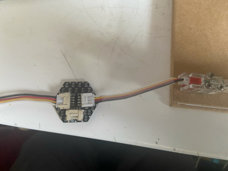

the range should be set to 155 as there are now 155 LEDs connected together.<br />
They should also be connected as below<br />
<img src="/assets/uploads/files/1655653784137-hex_cat-resized.png" alt="0_1655653766803_hex_cat.png" class=" img-fluid img-markdown" /></p>
<p dir="auto">However, this many LED's will cause power issues and you will need to build a power booster cable as shown in this guide.</p>
<p dir="auto"><a href="https://youtu.be/7MP_eG3U2So" target="_blank" rel="noopener noreferrer nofollow ugc">https://youtu.be/7MP_eG3U2So</a></p>
