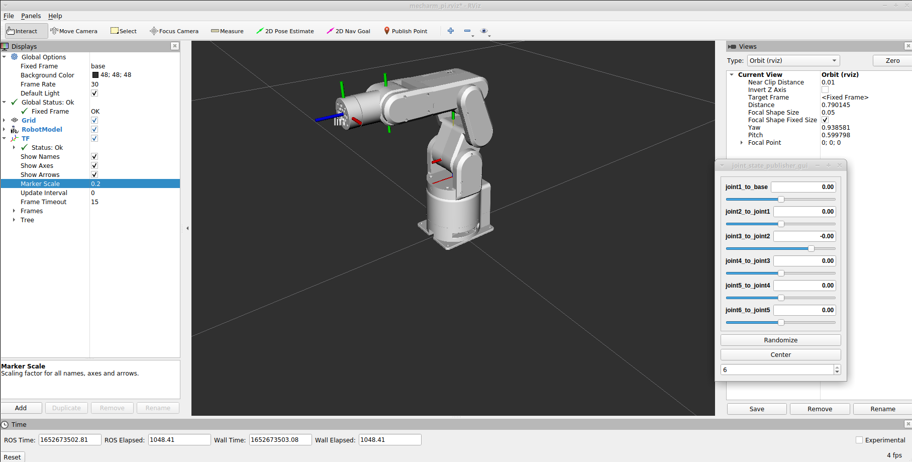

<p dir="auto">rviz and a slider component will be opened, and we will see the following interface:<br />
<img src="/assets/uploads/files/1655802447802-2.6.4ros-resized.png" alt="0_1655802447038_2.6.4ROS.png" class=" img-fluid img-markdown" /><br />
Then we can control the model in rviz to make it move by dragging the slider. If we want the real mechArm to move with the model, we need to open another command line and run:</p>

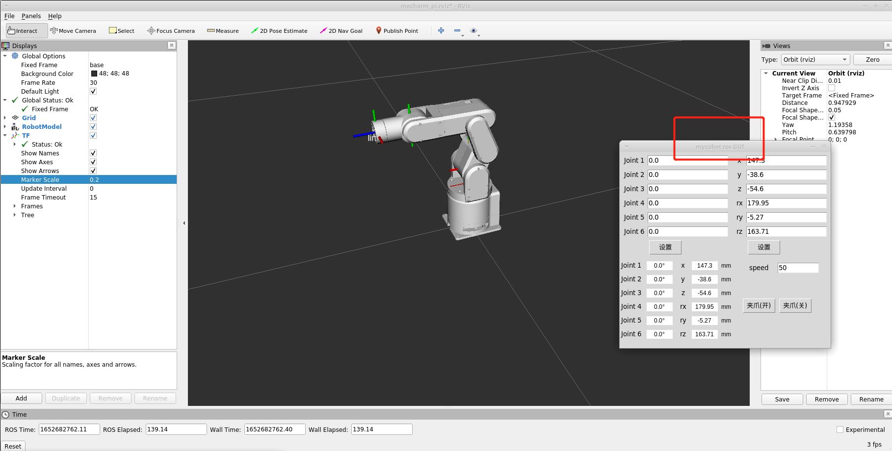

<p dir="auto"><strong>2.GUI control</strong><br />
Based on the previous contents, this package also provides a simple GUI control interface. This method is used to control the real robot arms. We should connect to mecharm first.</p>
<p dir="auto">Open a command line:</p>
<pre><code># The default serial port name of the mechArm version is "/dev/ttyAMA0", and the baud rate is 1000000".
roslaunch mecharm_pi simple_gui.launch port:=/dev/ttyAMA0 baud:=1000000
</code></pre>

<img src="/assets/uploads/files/1655802329292-gui-resized.jpg" alt="0_1655802328353_GUI.jpg" class=" img-fluid img-markdown" /></p>

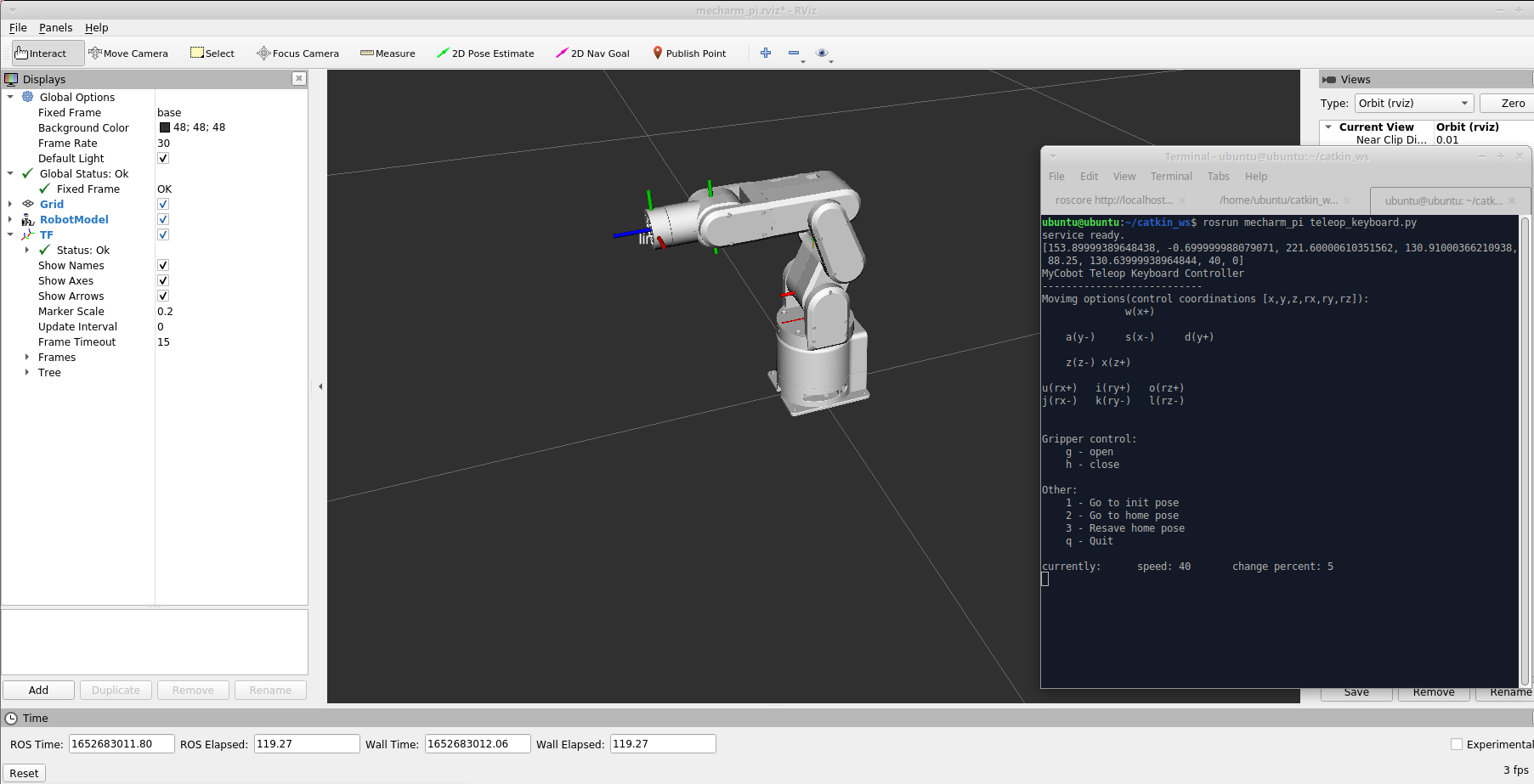

<p dir="auto">Running effect is as follows:<br />
<img src="/assets/uploads/files/1655802405650-mecharm_teleop-resized.png" alt="0_1655802404850_mecharm_teleop.png" class=" img-fluid img-markdown" /><br />
We can control the mechArm by keyboard as instructed in the command line, mechArm information will be output in the command line as follows:</p>

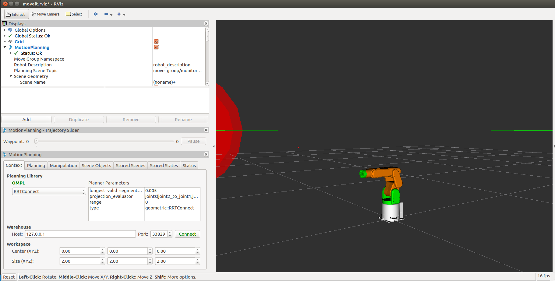

<p dir="auto">The operation effect is as follows:<br />
<img src="/assets/uploads/files/1655802527368-mecharm_moveit-resized.png" alt="0_1655802526495_mecharm_moveit.png" class=" img-fluid img-markdown" /><br />
If we want a real robot arm to execute a plan synchronously, we need to open another command line and run:</p>
rosrun mecharm_pi_moveit sync_plan.py _port:=/dev/ttyAMA0 _baud:=1000000
</code></pre>
