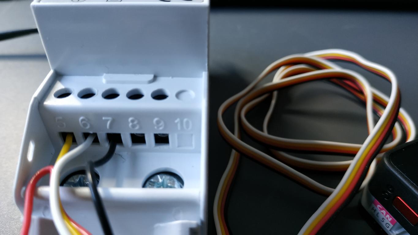

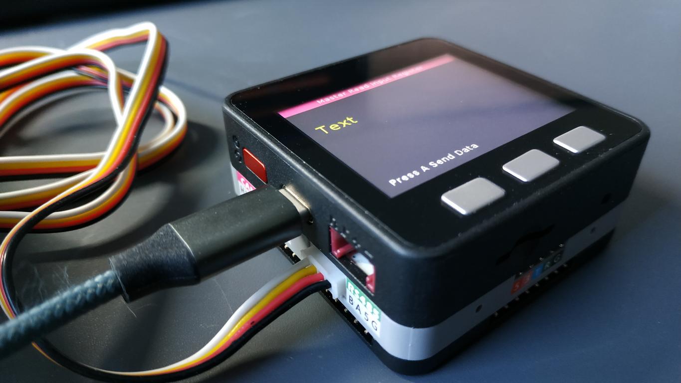

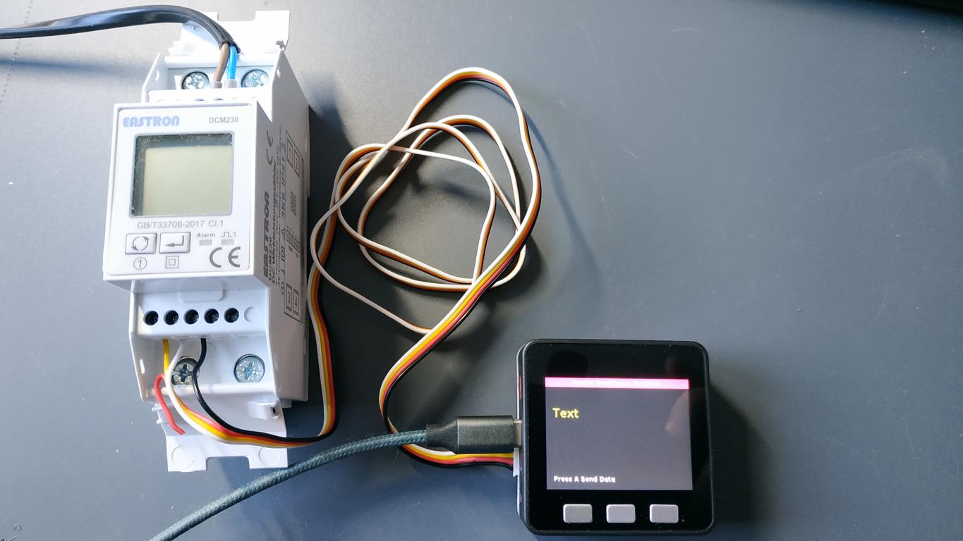

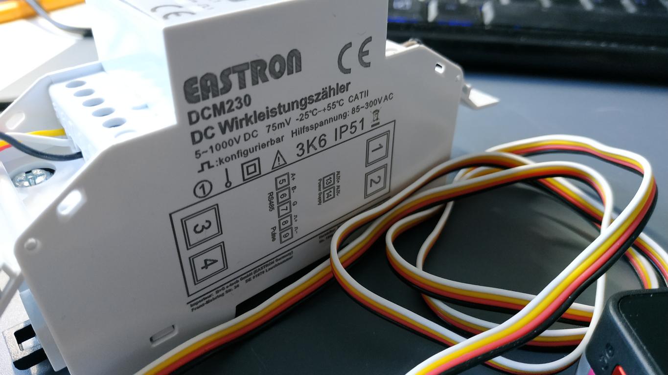

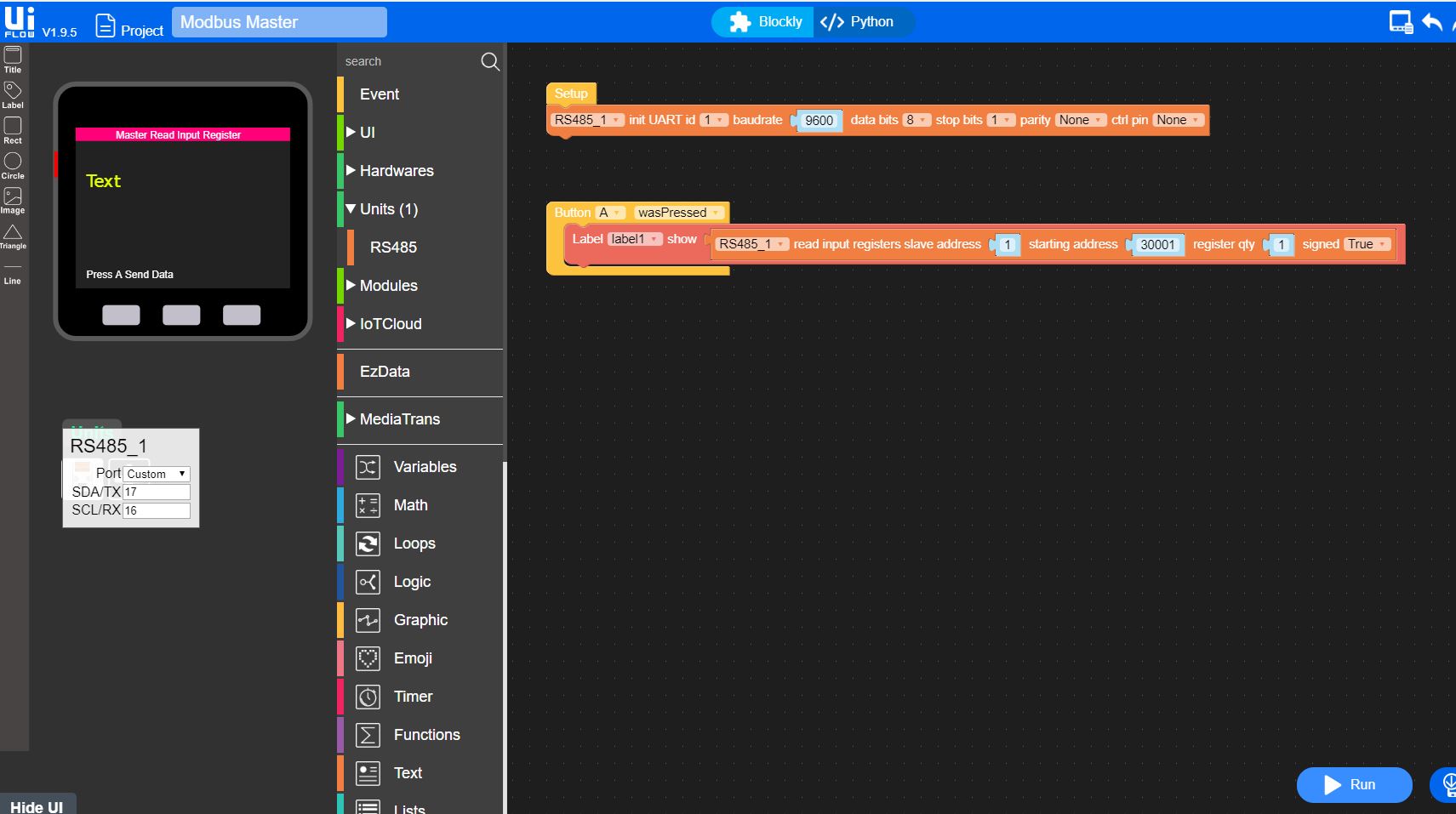

<p dir="auto">I want to use the RS485 from the COMMU module.</p>
<p dir="auto">But I am wondering why the differential voltage between A and B from RS485 signal is so small (800mV).<br />
I tried to connect it to a smart meter, but communication with M5Stack Core and COMMU via modbus protocoll isn´t possible.</p>
<p dir="auto">Configuration, software and signal see pictures. What´s wrong? I have no more ideas. So I assume, that voltage leves are to low.</p>
