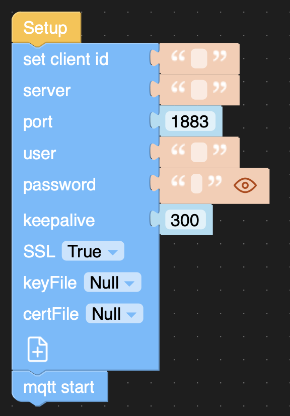

<p dir="auto">Thank you.<br />
LAN Base's MQTT init block does not have an entry to register a keyFile or certFile like the AWS block.</p>
<p dir="auto">... Maybe I have misunderstood the programming process itself.<br />
How can I use LAN Base to connect to AWS via wired LAN?</p>
<p dir="auto">You have to set SSL to true to get the cert but why not just use AWS setup does not care how you physically connect to the world as long as your core can access the WWW<br />
<img src="/assets/uploads/files/1658255332242-screenshot-2022-07-19-at-19.27.15.png" alt="0_1658255330344_Screenshot 2022-07-19 at 19.27.15.png" class=" img-fluid img-markdown" /></p>
