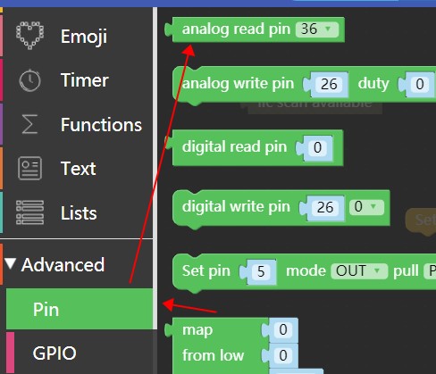

]]></description><link>https://community.m5stack.com/post/2322</link><guid isPermaLink="true">https://community.m5stack.com/post/2322</guid><dc:creator><![CDATA[jpilarski]]></dc:creator><pubDate>Fri, 04 Jan 2019 18:48:51 GMT</pubDate></item><item><title><![CDATA[Reply to potentially missing modules in UIFLOW on Wed, 02 Jan 2019 05:45:07 GMT]]></title><description><![CDATA[<p dir="auto">If you need adc function, it;s better to use "analog read pin &lt;36&gt;" block</p>
<p dir="auto"><img src="/assets/uploads/files/1546407901289-adc.jpg" alt="0_1546407901407_adc.JPG" class=" img-fluid img-markdown" /></p>

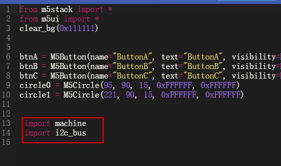

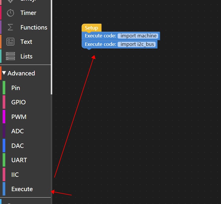

I have asked UIFlow team about this problem.<br />
They said that they forgot to add "import machine", but you can add it by execute block.<br />
<img src="/assets/uploads/files/1546403548859-commit.jpg" alt="0_1546403548710_commit.JPG" class=" img-fluid img-markdown" /><br />
<img src="/assets/uploads/files/1546403558002-11.jpg" alt="0_1546403558046_11.JPG" class=" img-fluid img-markdown" /></p>
