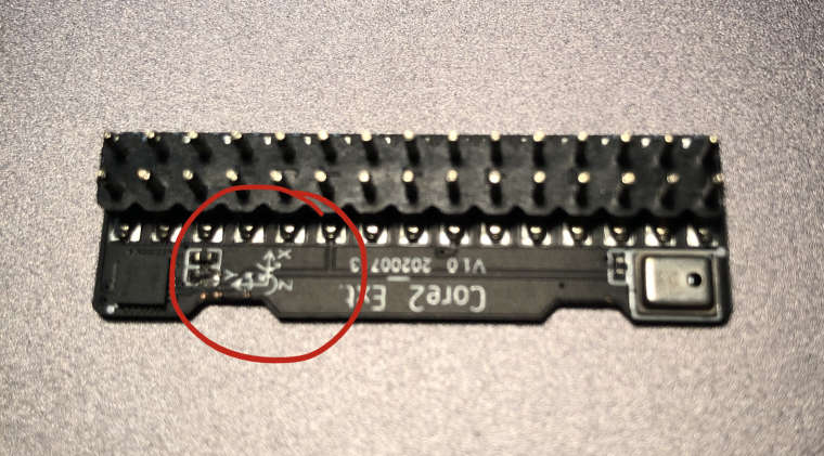

]]></description><link>https://community.m5stack.com/topic/4456/core2-does-not-start-after-replacing-core2-cover</link><generator>RSS for Node</generator><lastBuildDate>Wed, 29 Apr 2026 04:47:03 GMT</lastBuildDate><atom:link href="https://community.m5stack.com/topic/4456.rss" rel="self" type="application/rss+xml"/><pubDate>Sat, 23 Jul 2022 01:16:54 GMT</pubDate><ttl>60</ttl><item><title><![CDATA[Reply to Core2 does not start after replacing CORE2 cover on Wed, 10 Aug 2022 07:17:46 GMT]]></title><description><![CDATA[<p dir="auto">Hello <a class="plugin-mentions-user plugin-mentions-a" href="/user/kombistack" aria-label="Profile: Kombistack">@<bdi>Kombistack</bdi></a></p>
<p dir="auto">from what I can tell the damage isn't that severe. According to the schematic those two components are capacitors. I don't think they are critical for the overall functionality of the M5Core2, they might have an influence on the performance of the IMU though.</p>
<p dir="auto">That said, you should be able to resolder those with a small soldering iron. Or find someone who can fix it for you.</p>
<p dir="auto">I don't know if this board can be purchased separately as spare part. Have you checked with M5Stack support?</p>
<p dir="auto">Thanks<br />
Felix</p>

Further to my last post I have found that the real issue whereby my Core2 cover caused the Core2 to shut down when the cover was pushed back in place was due to damage to the Core2 cover.<br />
<img src="/assets/uploads/files/1660010988415-4f35b51a-8473-44d9-be4c-c3e4492802a1-resized.jpeg" alt="0_1660010928209_4F35B51A-8473-44D9-BE4C-C3E4492802A1.jpeg" class=" img-fluid img-markdown" /><br />
I obviously had damaged some of the components of the accelerometer when I removed the Core2 cover with a screwdriver!<br />
I hope I can purchase just a replacement cover.<br />
Something to be aware of when removing the Core2 cover.</p>
