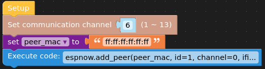

<p dir="auto">you could try to use an <code>Execute code:</code> block like this:</p>
<p dir="auto"><img src="/assets/uploads/files/1658805086183-uiflowespnowpeerpervar_20220726.png" alt="0_1658805084760_UIFlowESPNowPeerPerVar_20220726.png" class=" img-fluid img-markdown" /></p>
<p dir="auto">BTW: The content of the <code>Execute code:</code> block can be found by adding the <code>Add peer</code> block and then switching to the Python tab.</p>
<p dir="auto">Note: Above code is untested.</p>
<p dir="auto">Thanks<br />
Felix</p>
