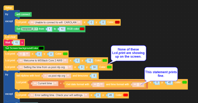

<p dir="auto">I've annotated what is not printing to the screen:</p>
<p dir="auto"><img src="/assets/uploads/files/1659364293357-d071c4ab-90c7-44cf-8c2d-d5b782b8ebfd-image-resized.png" alt="0_1659364291530_d071c4ab-90c7-44cf-8c2d-d5b782b8ebfd-image.png" class=" img-fluid img-markdown" /></p>

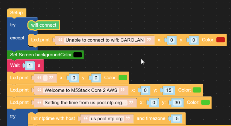

<p dir="auto"><img src="/assets/uploads/files/1659321687200-121a0ff3-0fb3-4c32-aadf-09b249114790-image-resized.png" alt="0_1659321685322_121a0ff3-0fb3-4c32-aadf-09b249114790-image.png" class=" img-fluid img-markdown" /></p>
