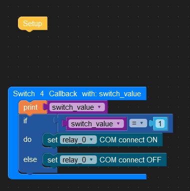

I am new to M5 Stack.<br />
I tried to control relay unit with Atom Lite, with Remote + switch, but it doesn’t work.</p>
<p dir="auto"><img src="/assets/uploads/files/1659970705164-4c4fa4ed-5380-4342-84d7-c791c35c8dcd-grafik.png" alt="0_1659970703957_4c4fa4ed-5380-4342-84d7-c791c35c8dcd-grafik.png" class=" img-fluid img-markdown" /></p>

<p dir="auto">It's also my experience that it doesn't always work if you have multiple switches, input fields, buttons, etc. I see "Switch 4" with you, so I assume that there are multiple switches.<br />
The solution I used in one of the projects with multiple input fields is to apply custom variables. Then suddenly it works! Hopefully that will help you too.</p>
<p dir="auto"><img src="/assets/uploads/files/1660660398174-input_value-resized.jpg" alt="0_1660660381449_Input_value.jpg" class=" img-fluid img-markdown" /></p>
