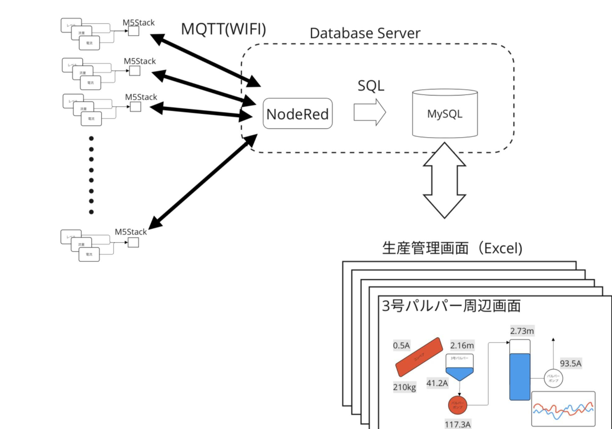

<p dir="auto"><a class="plugin-mentions-user plugin-mentions-a" href="/user/ajb2k3" aria-label="Profile: ajb2k3">@<bdi>ajb2k3</bdi></a>  I'm still learning and it will take some time before I can share it.<br />
We recycle paper from waste paper at our factory. I would like to manage production by atacching M5Stack to various machines and taking values with sensors. I introduced M5Stack and Stick a few months ago, and now I can stably obtain 4 current values, send them to the database from Node-red, and manage them with Excel. If the test of Station goes well, I want to use Station a lot.<br />
There are many machines in our factory and the future is long, so please give me some advice if I have any more questions. Thanks<br />
<img src="/assets/uploads/files/1661410085999-f9ce0ec0-5542-420d-8cb2-5f0afc8401de-image-resized.png" alt="0_1661410064788_f9ce0ec0-5542-420d-8cb2-5f0afc8401de-image.png" class=" img-fluid img-markdown" /><br />

]]></description><link>https://community.m5stack.com/post/18455</link><guid isPermaLink="true">https://community.m5stack.com/post/18455</guid><dc:creator><![CDATA[ajb2k3]]></dc:creator><pubDate>Thu, 25 Aug 2022 11:25:58 GMT</pubDate></item><item><title><![CDATA[Reply to M5Station-485 on Thu, 25 Aug 2022 06:53:20 GMT]]></title><description><![CDATA[<p dir="auto"><a class="plugin-mentions-user plugin-mentions-a" href="/user/ajb2k3" aria-label="Profile: ajb2k3">@<bdi>ajb2k3</bdi></a>  I'm still learning and it will take some time before I can share it.<br />
<img src="/assets/uploads/files/1661410085999-f9ce0ec0-5542-420d-8cb2-5f0afc8401de-image-resized.png" alt="0_1661410064788_f9ce0ec0-5542-420d-8cb2-5f0afc8401de-image.png" class=" img-fluid img-markdown" /></p>
