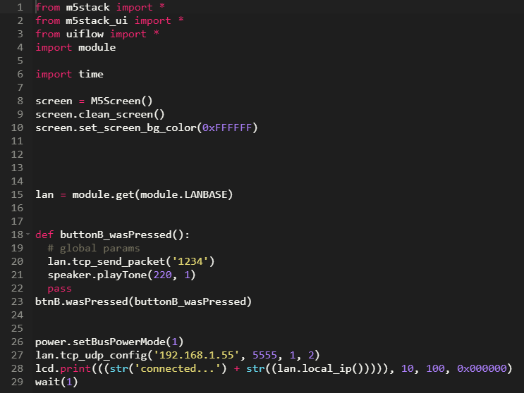

<p dir="auto"><img src="/assets/uploads/files/1660733079946-ss12106.png" alt="0_1660733093633_ss12106.png" class=" img-fluid img-markdown" /></p>
<p dir="auto">Even if I select [Modules-&gt;LAN_Base-&gt;Init block] to initialize the LAN module in Blockly, No Python code is generated to assign a fixed IP.</p>

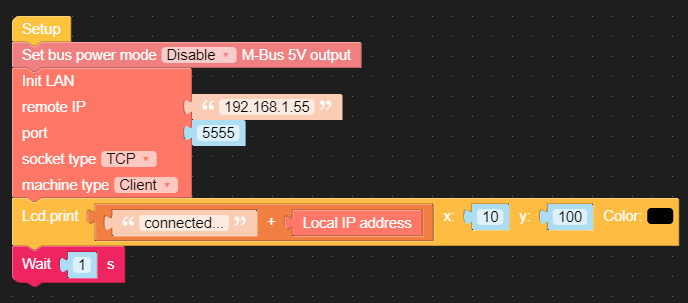

<p dir="auto"><img src="/assets/uploads/files/1660733417359-ss12110.png" alt="0_1660733430444_ss12110.png" class=" img-fluid img-markdown" /></p>

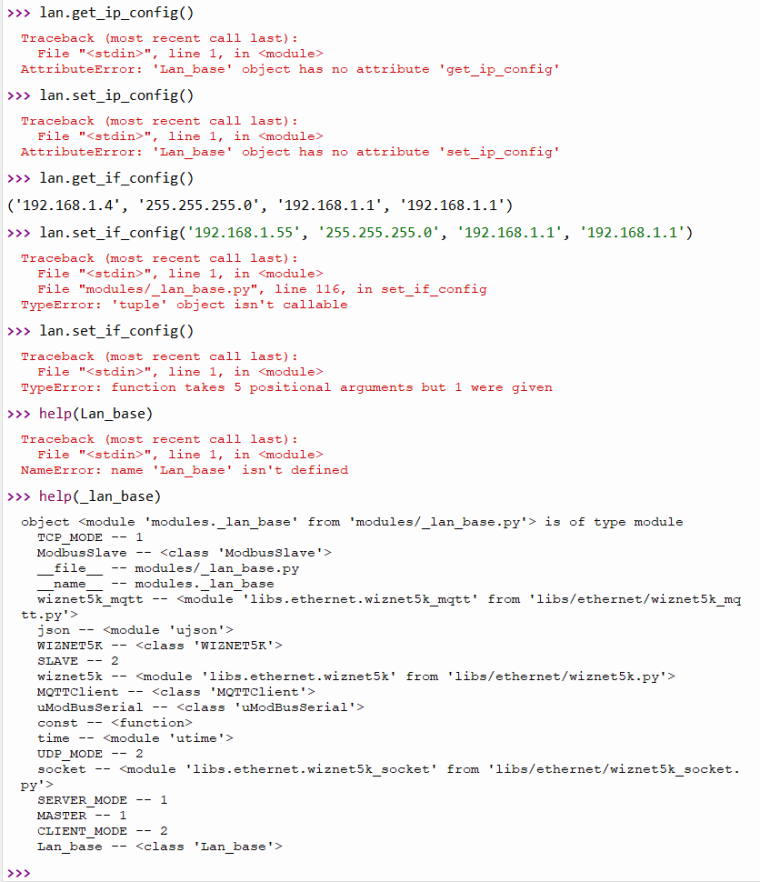

<p dir="auto">I tried [lan.get_if_config()] you suggested with the shell of [Windows 10, Thonny(v4.0.0.b3)].</p>
<p dir="auto"><img src="/assets/uploads/files/1660820321826-12120-resized.png" alt="0_1660820335050_12120.png" class=" img-fluid img-markdown" /></p>
<p dir="auto">While doing other trial and error, It seems that [libs/ethernet/wiznet5k.py] and [libs/ethernet/wiznet5k_dhcp.py] were running behind [lan = module.get(module.LANBASE)].</p>
<p dir="auto">If we can operate here directly..., can't you read [libs/ethernet/wiznet5k.py]? :-&lt;</p>

<p dir="auto">there is a <code>lan.get_if_config()</code> function which returns the current IP etc. as a 4 tuple like this <code>('192.168.x.x', '255.255.255.0', '192.168.x.1', '8.8.8.8')</code>.</p>
<p dir="auto">I also found there is a <code>lan.set_if_config()</code> function but when I feed the above 4 tuple as argument I get an error that the function takes 5 positional parameter, but only 2 are given. I tried many other ways to format the 4 arguments, but all I got are different error messages.</p>
<p dir="auto">Thanks<br />
Felix</p>
<p dir="auto">Edit: corrected incorrect <code>lan.get_ip_config()</code> - should be <code>lan.get_if_config()</code> (same for set)</p>
