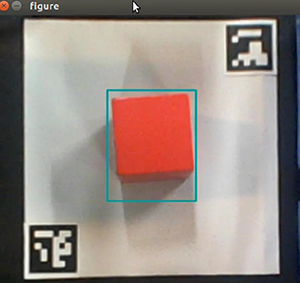

<p dir="auto">If the other colors don't have the HSV parameter added, then the block will be grabbed into the gray bucket by default in the program.<br />
<img src="/assets/uploads/files/1660817946174-%E7%BA%A2%E8%89%B2%E5%9B%BE%E7%89%871.png" alt="0_1660817946152_红色图片1.png" class=" img-fluid img-markdown" /><br />
<img src="/assets/uploads/files/1660817949573-%E7%81%B0%E5%BA%A6%E5%9B%BE%E7%89%87.jpg" alt="0_1660817949607_灰度图片.jpg" class=" img-fluid img-markdown" /><br />
After successfully recognising the color, it's time to get the coordinate information of the block.<br />
The final returned data is the coordinates of the center point of the blocks.<br />

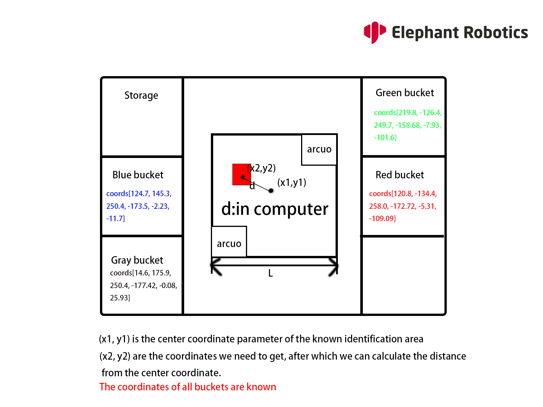

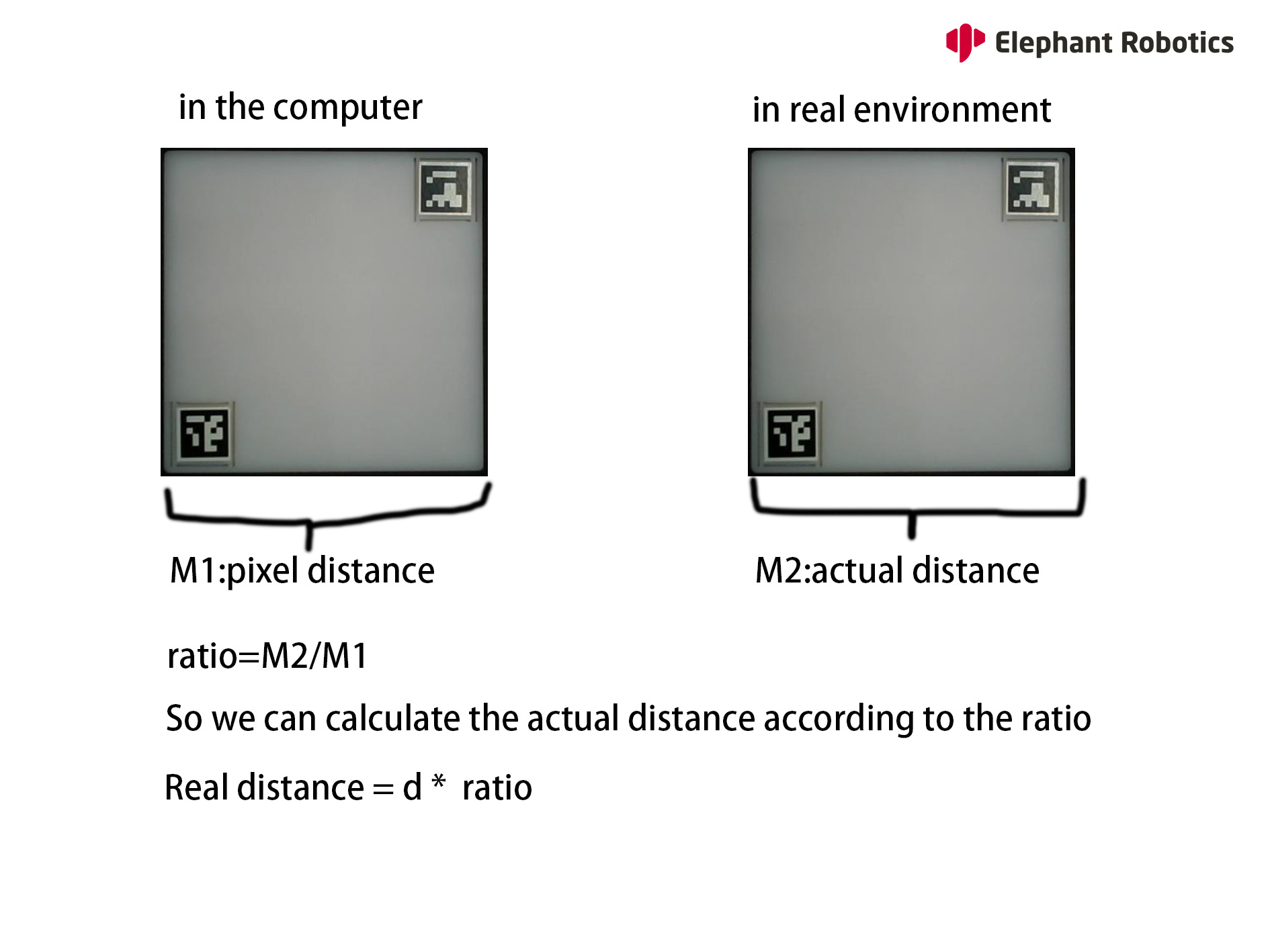

<p dir="auto"><strong>2. How to get the real coordinates from the information of the blocks？</strong><br />
To solve this problem, we need to deal with the ratio between the distance in computer and reality.<br />
<img src="/assets/uploads/files/1660818013712-ratio-explan-resized.jpg" alt="0_1660818013500_ratio explan.jpg" class=" img-fluid img-markdown" /><br />
<img src="/assets/uploads/files/1660818021928-radio1-resized.jpg" alt="0_1660818021438_radio1.jpg" class=" img-fluid img-markdown" /><br />
Except for the coordinates of the blocks in the recognition area, the rest of the parameters are known, such as the distance of the camera from the center point of the robotic arm base, the length of the Arcuo board, and the coordinates of the center of the Arcuo board, so the  ratio is also known.<br />
<img src="/assets/uploads/files/1660818071206-8.8ps-resized.png" alt="0_1660818071108_8.8ps.png" class=" img-fluid img-markdown" /><br />
<em>(The coordinates of the buckets have been set in the program in advance. When the corresponding colors are identified, the blocks will be grabbed into the corresponding buckets.<br />
The blocks of other colors that are not added in advance in HSV will be put into gray buckets)</em></p>
<p dir="auto">Therefore, we can get the distance in the computer and then calculate the actual distance of <strong>d</strong> to achieve this function.<br />
