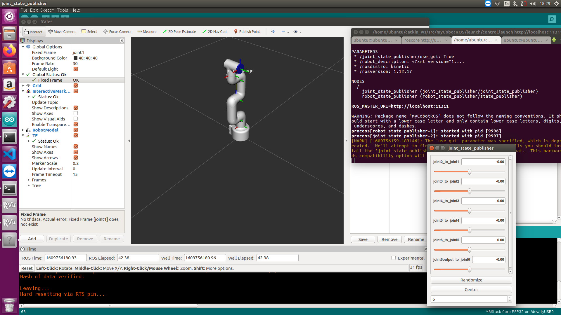

Slider Control：</strong><br />
Move the slider to control the movement of myCobot280, and the movement of myCobot280 will be fed into the RVIZ interface in real time.<br />

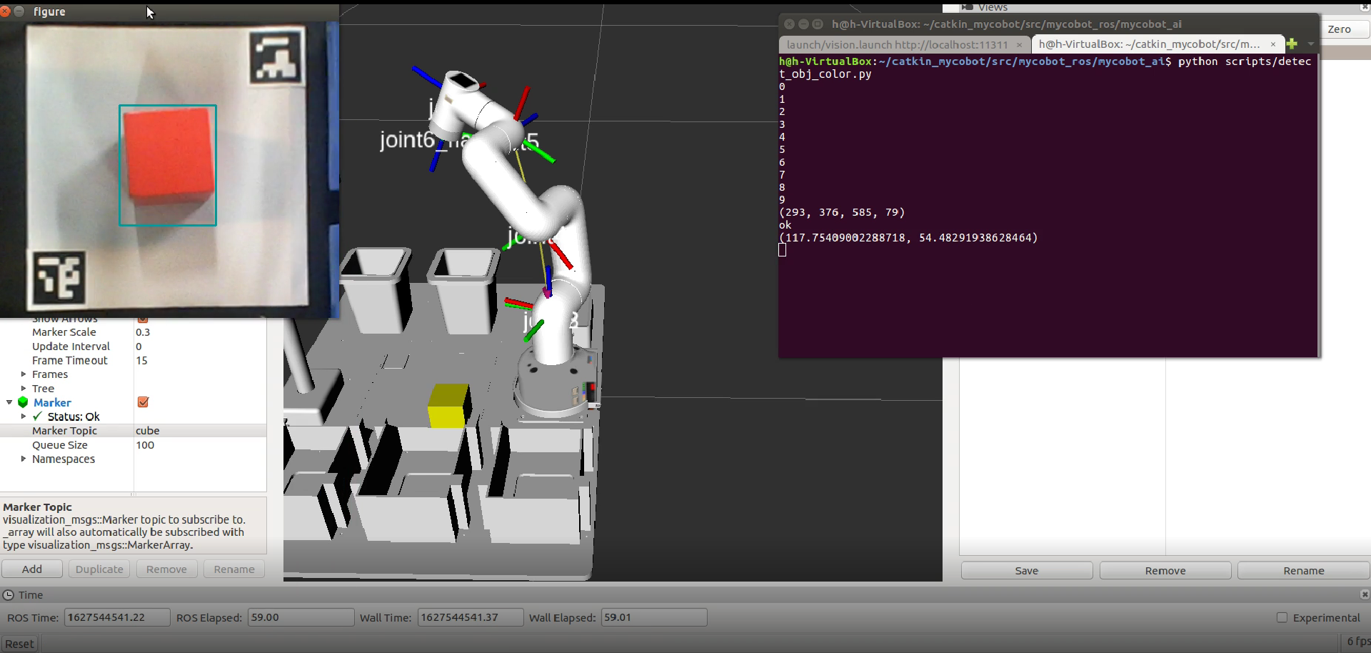

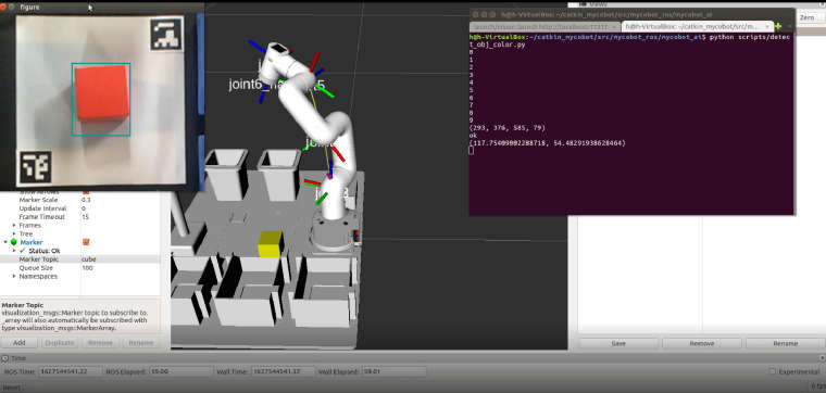

<strong>Artificial Intelligence Kit：</strong><br />
Guide the robot through robot vision and realize intelligent grabbing simultaneously. The intellectual grabbing of wood blocks and the intelligent grabbing of image objects have been developed.<br />
