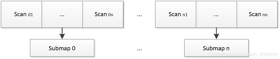

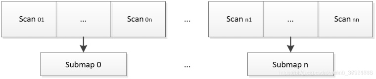

<p dir="auto"><strong>2.1.2 Cartographer algorithm</strong><br />
Cartographer is a set of <strong>SLAM</strong> algorithms based on graph optimization.<br />
The cartographer algorithm mainly uses the concept of <strong>Submap</strong>. Whenever the data of a laser <strong>Scan</strong> is obtained, it is matched with the currently recently established <strong>Submap</strong> so that the laser <strong>Scan</strong> data of this frame is inserted into the optimal position on it. The <strong>Submap</strong> is also updated while inserting new data frames. A certain amount of data is combined into a <strong>Submap</strong>, if there is no new <strong>Scans</strong> are inserted into the <strong>Submap</strong>, it is considered that the <strong>Submap</strong> has been created, and then the next Submap will be created. The specific process is as follows.<br />
<img src="/assets/uploads/files/1662101428544-p4-resized.png" alt="0_1662101428056_p4.png" class=" img-fluid img-markdown" /><br />
All created <strong>Submaps</strong> and the current laser <strong>Scan</strong> will be used for <strong>Scan</strong> matching for loopback detection. Loopback detection is performed if the recent Scan and all created Submaps are close enough in the distance. After the loopback detection is completed, the map construction is completed, too.<br />

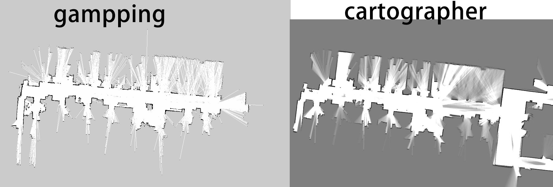

Some people may doubt why introducing two algorithms for building a map.<br />
Let's compare the two algorithms to solve this doubt.<br />
Gmapping can build indoor maps in real-time, requiring less computation and higher accuracy in building small scene maps. Compared with Cartographer when building a small scene map, Gmapping does not require too many particles and has no loopback detection, so the amount of calculation is less than that of Cartographer, and the accuracy is not much worse. When building a small scene map, compared with Cartographer, Gmapping is not only fast but also can build high-precision maps, and the number of particles required for Gmapping to expand the map can easily burst the memory. The latter can solve the problem of map expansion, and the effect of mapping can be excellent (the above picture is in the same terrain).<br />
<img src="/assets/uploads/files/1662101544267-gvsc-resized.jpg" alt="0_1662101543574_gvsc.jpg" class=" img-fluid img-markdown" /><br />

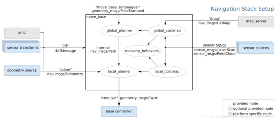

<strong>2.2 Map Navigation</strong><br />
In the map we built in the previous step, the robot can automatically navigate to a certain destination on the map. This all stems from the navigation function package of ROS.<br />
<img src="/assets/uploads/files/1662101568635-p6-resized.png" alt="0_1662101568126_p6.png" class=" img-fluid img-markdown" /><br />
<strong>move_base in navigation:</strong><br />
<strong>global planner：</strong><br />
The overall path planning is carried out according to the given target position.<br />
In the navigation of ROS, the global route of the robot to the target position is calculated first through international path planning. The Navfn package implements this function. Through Dijkstra's optimal path algorithm, Navfn calculates the minimum cost path on the cost map as the robot's global route.<br />
<strong>local planner：</strong><br />
Plan the avoidance route based on nearby obstacles.<br />
Local real-time planning is implemented using the <strong>base_local_planner</strong> package. This package uses the <strong>Trajectory Rollout</strong> and <strong>Dynamic-Window approaches</strong> algorithms to calculate the speed and angle (dx, dy, dtheta velocities) the robot should travel during each cycle.<br />
The <strong>base_local_planner</strong> package uses map data to search for multiple paths to the target through algorithms, uses some evaluation criteria (whether it will hit an obstacle, the time required, etc.) to select the optimal path, and calculate the required real-time speed and angle.<br />

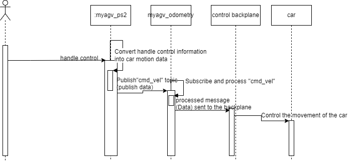

<strong>2.3 PS2 handler control</strong><br />
As a mobile robot, wireless control is essential.<br />
We developed the ps2 handler to control myAGV so that myAGV can move freely and realize more possibilities.<br />
The following is the sequence diagram of our handle control. Maybe it can provide some ideas for you to do more development on the handle.<br />
<img src="/assets/uploads/files/1662101652690-%E6%89%8B%E6%9F%84%E6%8E%A7%E5%88%B6.drawio.png" alt="0_1662101652187_手柄控制.drawio.png" class=" img-fluid img-markdown" /><br />
