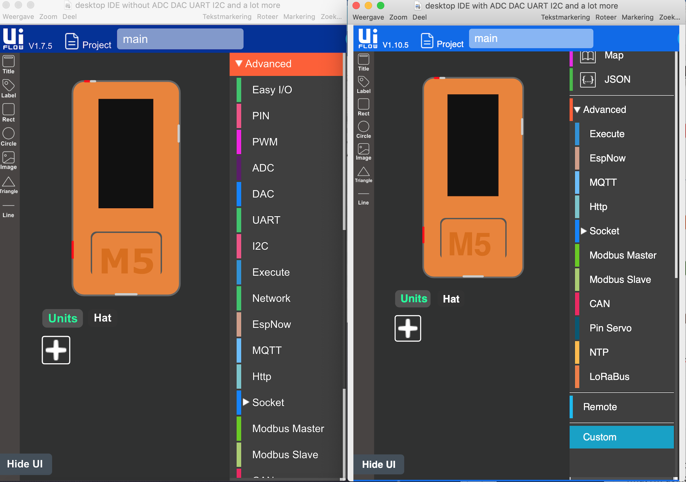

<?xml version="1.0" encoding="UTF-8"?><rss xmlns:dc="http://purl.org/dc/elements/1.1/" xmlns:content="http://purl.org/rss/1.0/modules/content/" xmlns:atom="http://www.w3.org/2005/Atom" version="2.0"><channel><title><![CDATA[Webbased UIflow &quot;Advanced&quot; misses things like UART]]></title><description><![CDATA[<p dir="auto">I must overlook something but in the webbed UIflow (V1.10.05 but since webbed always the most recent version I guess)  "Advanced" shows totally different topics than the "desktop UIflow" in the webbed version, no ADC/DAC/UART/I2C and a lot more .. no idea what I'm doing wrong .. Martin<img src="/assets/uploads/files/1663129162327-schermafbeelding-2022-09-14-om-06.18.35-resized.png" alt="0_1663129156693_Schermafbeelding 2022-09-14 om 06.18.35.png" class=" img-fluid img-markdown" /></p>

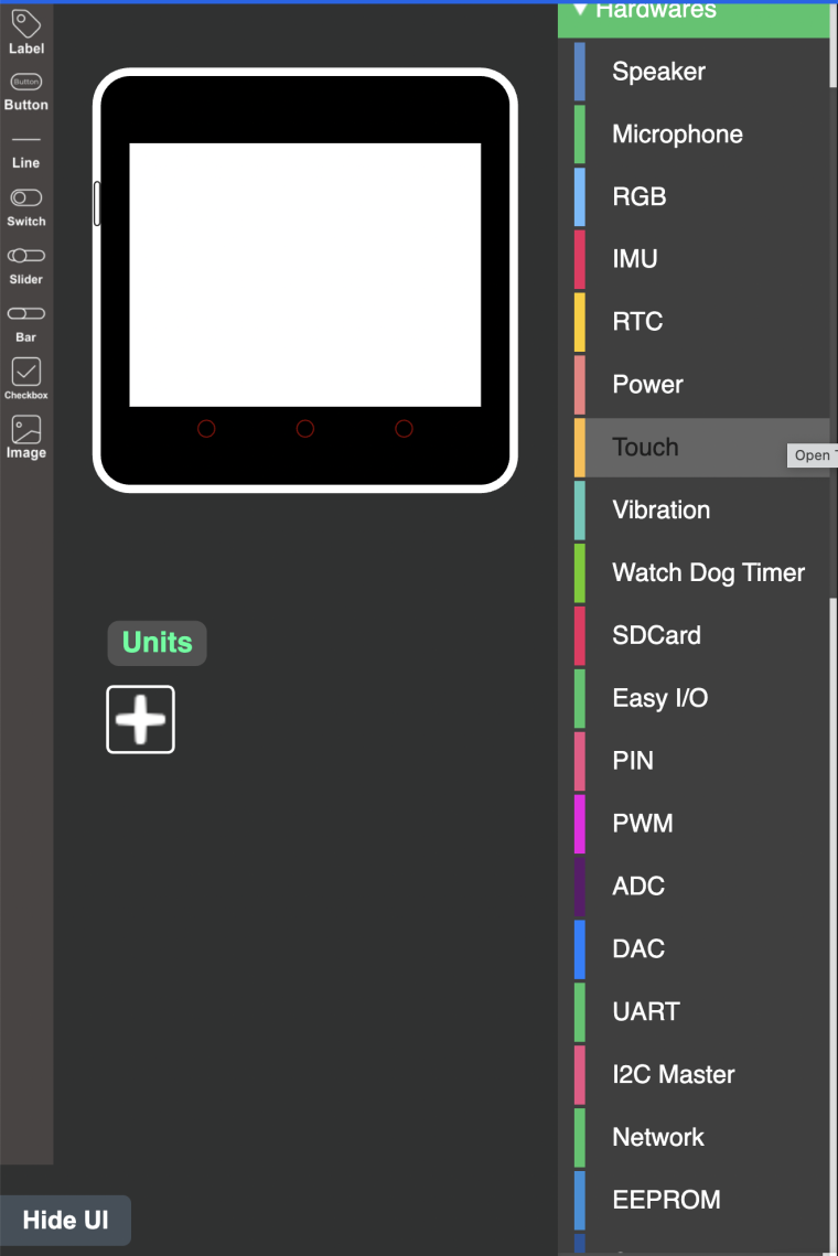

]]></description><link>https://community.m5stack.com/topic/4605/webbased-uiflow-advanced-misses-things-like-uart</link><generator>RSS for Node</generator><lastBuildDate>Wed, 29 Apr 2026 18:17:47 GMT</lastBuildDate><atom:link href="https://community.m5stack.com/topic/4605.rss" rel="self" type="application/rss+xml"/><pubDate>Wed, 14 Sep 2022 04:19:40 GMT</pubDate><ttl>60</ttl><item><title><![CDATA[Reply to Webbased UIflow &quot;Advanced&quot; misses things like UART on Wed, 14 Sep 2022 19:37:03 GMT]]></title><description><![CDATA[<p dir="auto"><a class="plugin-mentions-user plugin-mentions-a" href="/user/martingrotendag" aria-label="Profile: martingrotendag">@<bdi>martingrotendag</bdi></a> A lot of the functions were removed from advanced folder to the hardware folder. <img src="/assets/uploads/files/1663184204324-screenshot-2022-09-14-at-20.36.33-resized.png" alt="0_1663184202089_Screenshot 2022-09-14 at 20.36.33.png" class=" img-fluid img-markdown" /></p>

1.7.5 and 1.10.5 are not the same.</p>
<p dir="auto">You have to download the newest version here : <a href="https://static-cdn.m5stack.com/resource/software/UIFlow-Desktop-IDE.zip" target="_blank" rel="noopener noreferrer nofollow ugc">https://static-cdn.m5stack.com/resource/software/UIFlow-Desktop-IDE.zip</a><br />
this is Version 1.9.5</p>
<p dir="auto">M5Stack announced that this is the last offline version.</p>
<p dir="auto">In future, there is only the online version available.<br />
For most users sufficient.  But if you have to programm severla devices for a company internal application, wihtout cloud and internet access, how would you do that ?</p>
