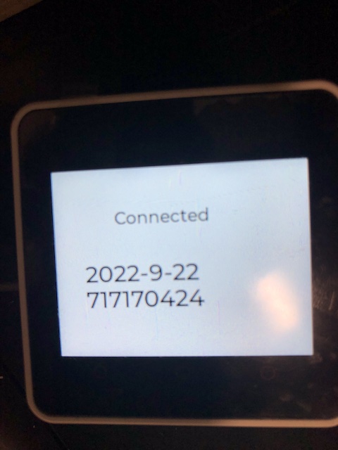

]]></description><link>https://community.m5stack.com/post/19779</link><guid isPermaLink="true">https://community.m5stack.com/post/19779</guid><dc:creator><![CDATA[ondrej1024]]></dc:creator><pubDate>Sun, 08 Jan 2023 17:10:41 GMT</pubDate></item><item><title><![CDATA[Reply to ntptime.getTimestamp returns incorrect timestamp. on Thu, 22 Sep 2022 14:44:09 GMT]]></title><description><![CDATA[<p dir="auto"><img src="/assets/uploads/files/1663857822895-img_1182.jpg" alt="0_1663857818576_IMG_1182.jpg" class=" img-fluid img-markdown" /></p>
<p dir="auto">hi <a class="plugin-mentions-user plugin-mentions-a" href="/user/ajb2k3" aria-label="Profile: ajb2k3">@<bdi>ajb2k3</bdi></a> ～</p>
<p dir="auto">Thank you so much for the reply.</p>
<p dir="auto">As you can see from the screenshot:<br />
the year-month-day (text2) shows expected date-time though.<br />
I would assume that we do have successful ntp connection because of text2.<br />
In my real code, the time-server is set as our internal time-server, and the timezone is set as 0 (for UTC).</p>
