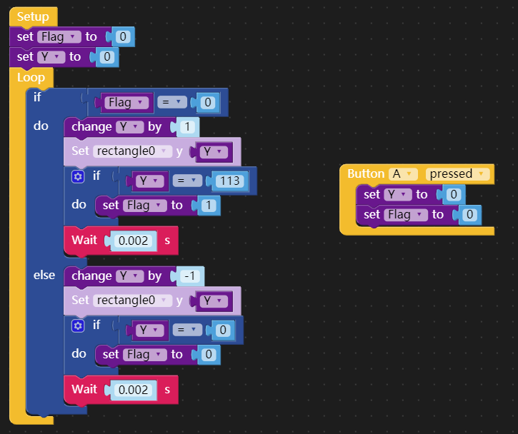

]]></description><link>https://community.m5stack.com/post/2311</link><guid isPermaLink="true">https://community.m5stack.com/post/2311</guid><dc:creator><![CDATA[m5-docs]]></dc:creator><pubDate>Thu, 03 Jan 2019 03:06:34 GMT</pubDate></item><item><title><![CDATA[Reply to M5Stick&#x27;s mini and UIFlow on Thu, 03 Jan 2019 03:03:05 GMT]]></title><description><![CDATA[<p dir="auto">Hi, Happy New Year!<br />

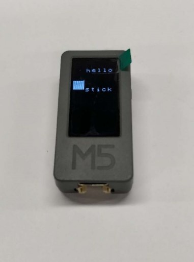

Recently, uiflow has supported m5stick. And you can use m5stick's OLED screen with uiflow.<br />
<img src="/assets/uploads/files/1546484573612-%E5%BE%AE%E4%BF%A1%E5%9B%BE%E7%89%87_20190103105058.jpg" alt="0_1546484573158_微信图片_20190103105058.jpg" class=" img-fluid img-markdown" /><br />
Here's the documentation and example code for stick:</p>
<p dir="auto"><a href="https://docs.m5stack.com/#/zh_CN/core/m5stick" target="_blank" rel="noopener noreferrer nofollow ugc">https://docs.m5stack.com/#/zh_CN/core/m5stick</a></p>
<p dir="auto"><a href="https://github.com/m5stack/M5-ProductExampleCodes/tree/master/Core/M5Stick/UIFlow" target="_blank" rel="noopener noreferrer nofollow ugc">https://github.com/m5stack/M5-ProductExampleCodes/tree/master/Core/M5Stick/UIFlow</a></p>
<p dir="auto">Thanks for all your support!</p>
