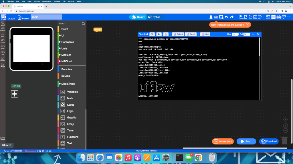

]]></description><link>https://community.m5stack.com/post/18766</link><guid isPermaLink="true">https://community.m5stack.com/post/18766</guid><dc:creator><![CDATA[Devan]]></dc:creator><pubDate>Fri, 30 Sep 2022 03:23:40 GMT</pubDate></item><item><title><![CDATA[Reply to Lost Serial number on Thu, 29 Sep 2022 15:59:12 GMT]]></title><description><![CDATA[<p dir="auto">Sorry, wasn't able to add pictures so lets try again.<img src="/assets/uploads/files/1664466770237-screenshot-2022-09-29-at-16.51.03web-resized.png" alt="0_1664466768020_Screenshot 2022-09-29 at 16.51.03web.png" class=" img-fluid img-markdown" /><br />

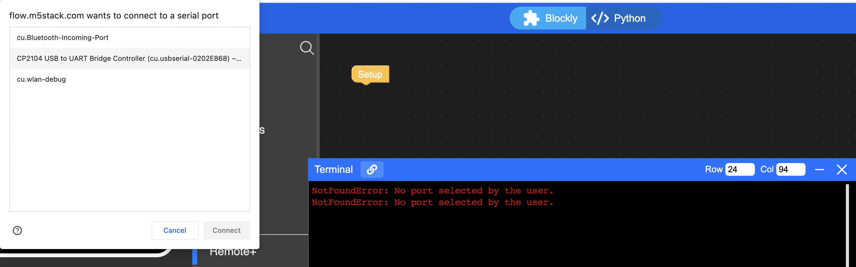

At the bottom of the screen on the right is an orange and 2 blue buttons, hit the orange button to access the terminal, click on the chain icon next to the word terminal to bring up the USB device list:<br />
<img src="/assets/uploads/files/1664466920040-screenshot-2022-09-29-at-16.54.52-resized.png" alt="0_1664466906285_Screenshot 2022-09-29 at 16.54.52.png" class=" img-fluid img-markdown" /><br />
Click on the device that is shown in the middle of the list (not Wlan or bluetooth) then click the connect button:<br />

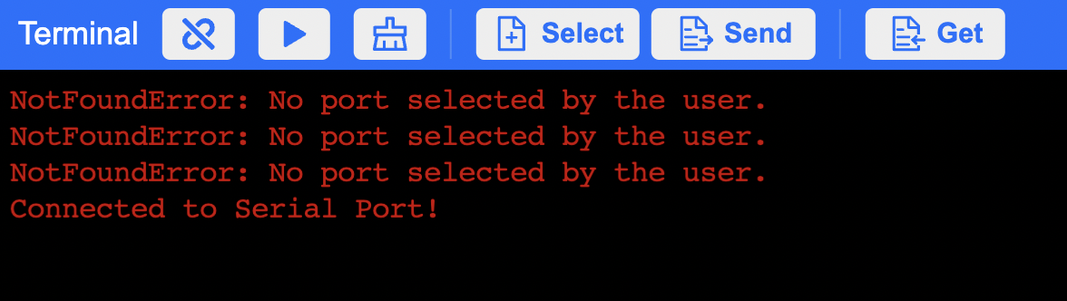

A message in red appears showing:<br />
<img src="/assets/uploads/files/1664467038069-screenshot-2022-09-29-at-16.57.06-resized.png" alt="0_1664467035936_Screenshot 2022-09-29 at 16.57.06.png" class=" img-fluid img-markdown" /><br />
Press the reset button on the stick to reset the stick and loads of white text appears followed by the UIFLow logo and under that will be the unique API number that is needed to conned UIFLOw to the stick.</p>
